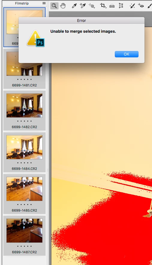

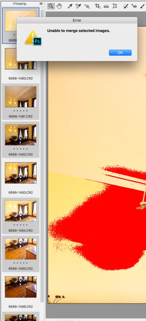

October 18, 2018
So... another job today!
Today I bracketed in stops (-1 0 +1) That's two stops between lightest & darkest!
Didn't work....    "Error unable to merge selected images"
Tried with various number of brackets... Didn't work
And.. Just in case there is any doubt about the merging side of things there is a screen shot of a fully merged but not bracketed shot!
Come on Adobe please explain how this should work - and why it doesn't for me?
