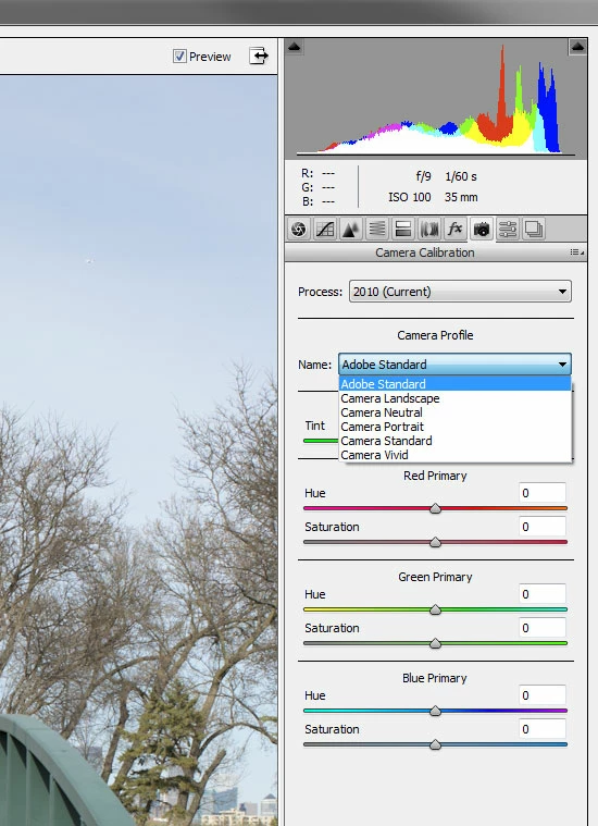

    April 11, 2012
    guys...
    i have a very similar problem ---
    i am really confuesd here..

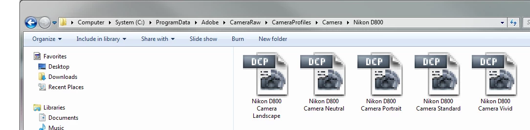

    i have been struggling to get d800 profliles to work in ps 5.1  I have loaded acr 6.7  and DNG Converter 6.7...
    the view for me in the ACR window for camera profiles when opening a d800 *.NEF file --
    all i see is this...
    i finally figured out how ti find my hidden folders --
    the profiles are indeed on my PC HD...
    how to i actually, use them?
    huge thanks guys!
