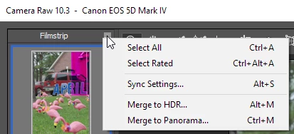

It's still there for me.  You have to select more than 1 image and they need to be compatible with each other: same size, same camera, etc:

yeah, that's not the problem....
I must say, it works at home. But at work (where I am not allowed to do any updates), the feature is just gone.......  funny thing is, the new creative Profiles and the dehaze slider are where they should be. So strange :-/
