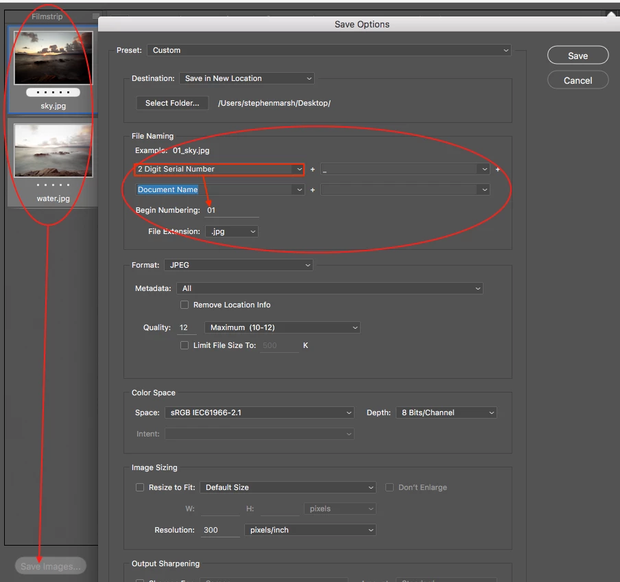

I'm looking for help in regards to numbering, when saving files in Camera RAW.  I want the first file saved to start with the number 1 rather than have no number, so that I can keep the order of images in tact.  It's a pain having to relabel that one file so that it appears first.  I've looked within CC and on this forum for answers but to no avail.  I can see the "Start Numbering With" option but it's grayed out and it's not accessible. Any help would be greatly appreciated. Thanks!

January 20, 2022
"Start numbering with" is grayed out unless you do this. In the "Save Options" box put your chosen file name as previous and then in the dropdown box to the immediate right, select one of the 1-6 digit numbers options. "Start Numbering With" can now be used. Phil.

I personally would use the batch tools built into ACR:
