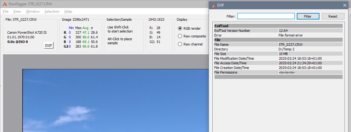

Per Berntsen
Feb 24, 2025 8:49 PM UTC
The Canon PowerShot A590IS is not on the list of supported cameras
I downloaded the file, but no Adobe application would open it. In the DNG converter I got "There was an error parsing the file".
RawDigger did open it, but reported a File format error, and displayed no metadata from the camera.
So apart from being unsupported by Adobe, there seems to be something wrong with the file.
