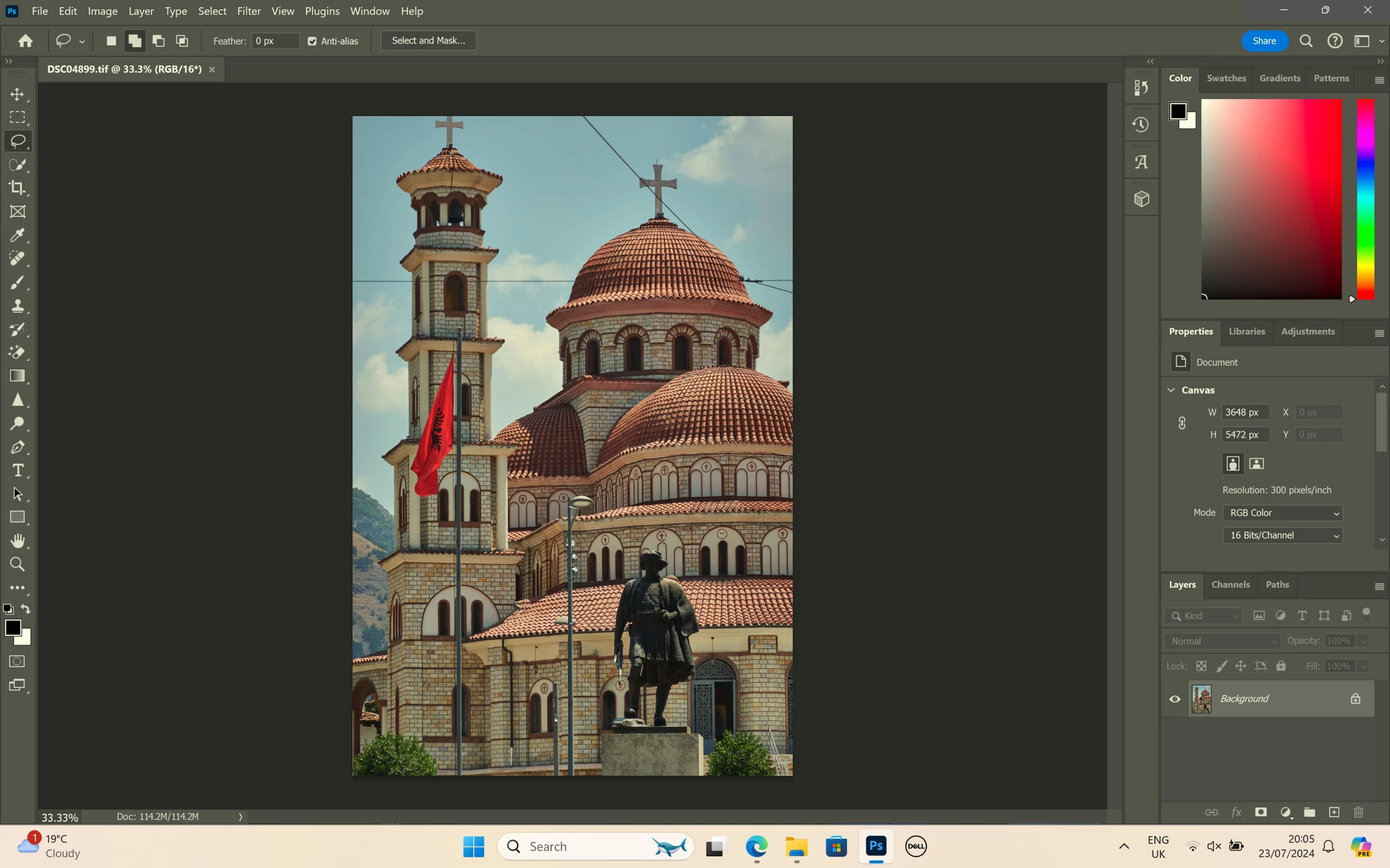

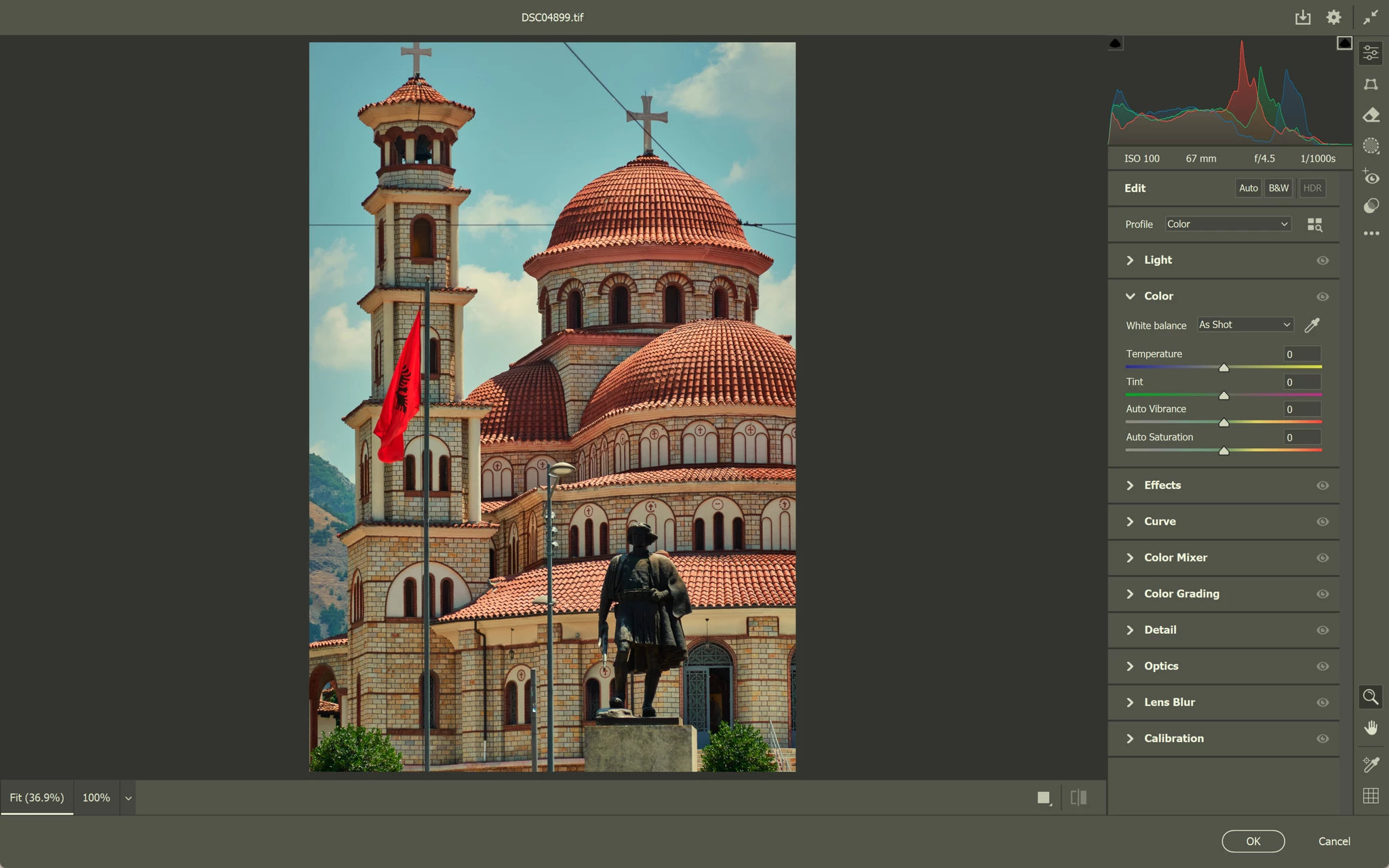

I have a sony camera.  I using convert the files in capture one the the tiff files I run though camera raw and photoshop.
Never had an issue until yesterday when I have found when I am processing the tiff files in camera raw they are much more saturated then when they are open in photoshop.
It means I can't really do any adjustments in camera raw anymore as the end result isn't what gets pushed across to photoshop.  See two screen grabs as example.

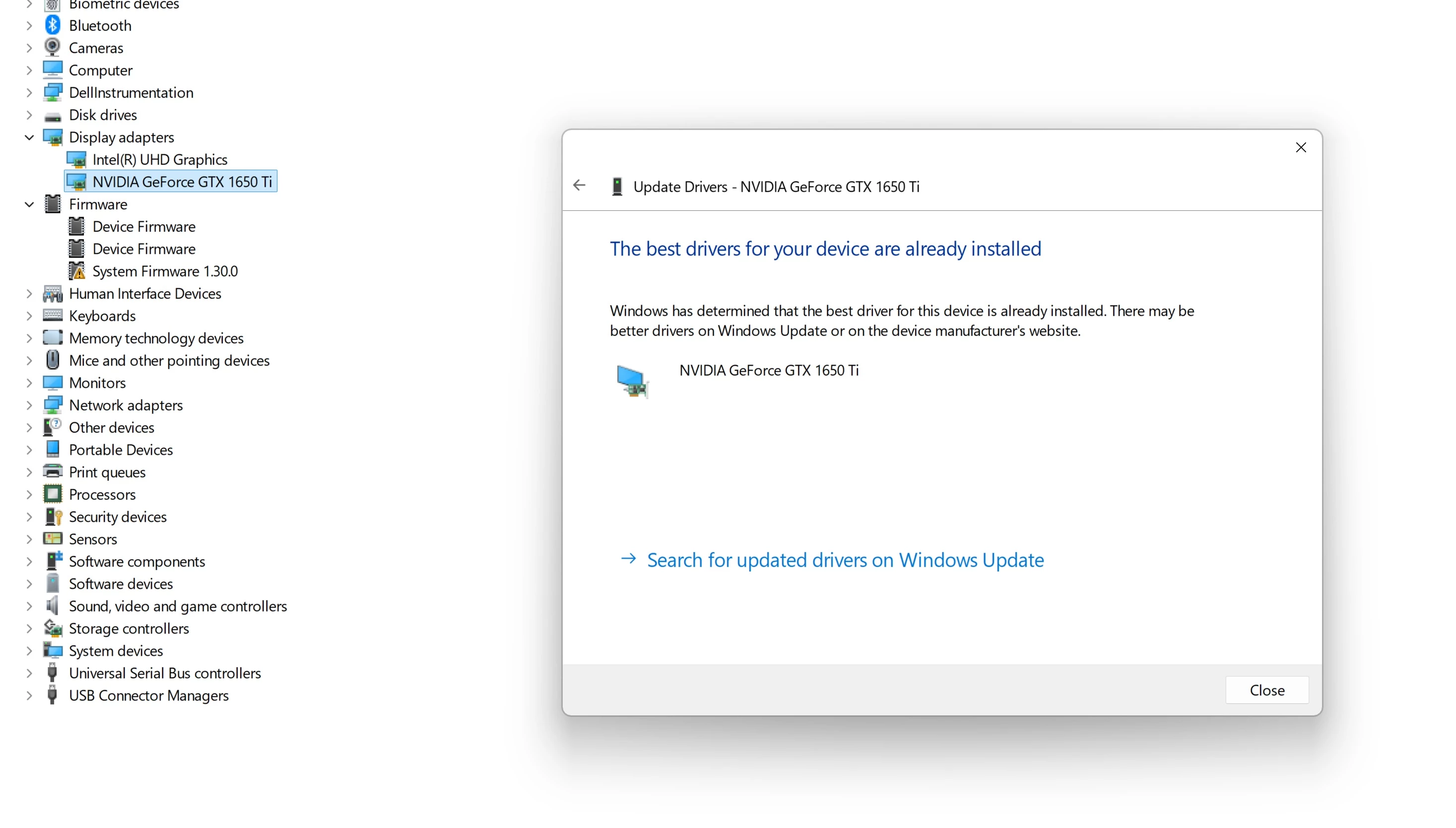

    And is your GPU driver up to date? If you have an Nvidia GPU, use the Studio driver, not the Game ready driver.
    Jul 27, 2024 4:31 PM UTC
    It said the drivers were up to date but noticed in photoshop under the help tab when checking it siad they were out of date so downloaded a driver from Nvidia direct and chose studio driver and seems to have done the job.

    The interface in both PS and ACR should be a neutral grey, but yours have a yellow cast.
    This indicates that you may have a defective monitor profile, which will also cause images to display with wrong colors.
    A defective monitor profile can affect different applications differently – here it seems that PS is unaffected, but ACR displays over saturated. It is also possible that both are wrong, PS could be displaying the image with the same yellow cast as the interface.
    To check for a defective monitor profile, try setting it to sRGB (use Adobe RGB if you have a wide gamut monitor).

    If the problem persists, make sure that that your GPU driver is up to date. As far as I know, it's the GPU that handles the conversion from the document profile to the monitor profile (this is basically how color management works).
    I have inserted your screenshots below.
