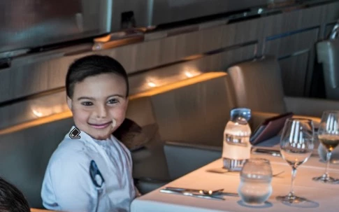

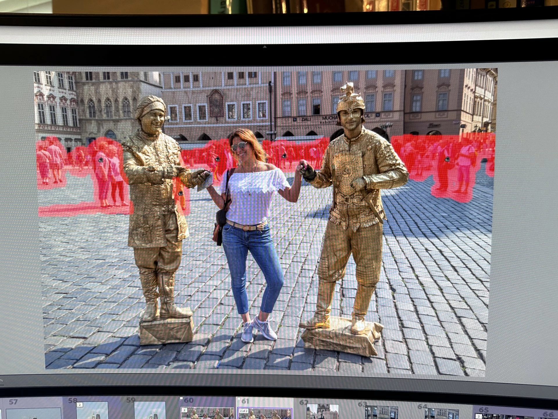

August 15, 2025
The AI seems to think that this is a distracting person!  I have tried the distraction removal tool on a number of photos. Sometimes it did not recognise a distracting person at all. I think it is more useful to include an option for us to highlight/mask an area for the ai to concentrate on finding the distraction.

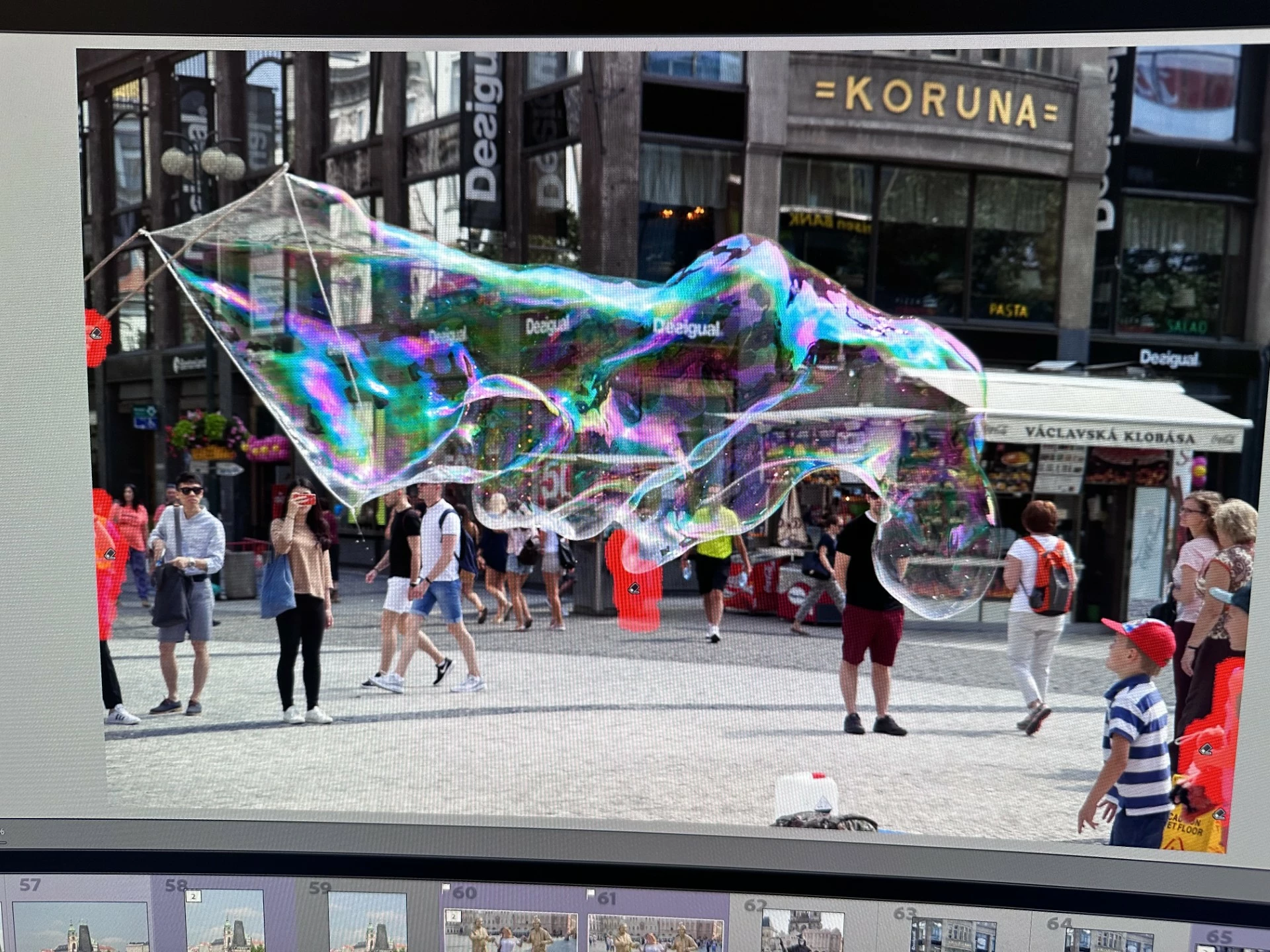

August 15, 2025
I havae tried to use this so many times. Sometimes it picks one and removes it. BUT the rest of the time it adds a weird person instead. Why? and when there are multiple people I want to remove, I can't pick anyone else. So I have to use the other tools. It is totally random if it is going to work. Mostly doesn't.

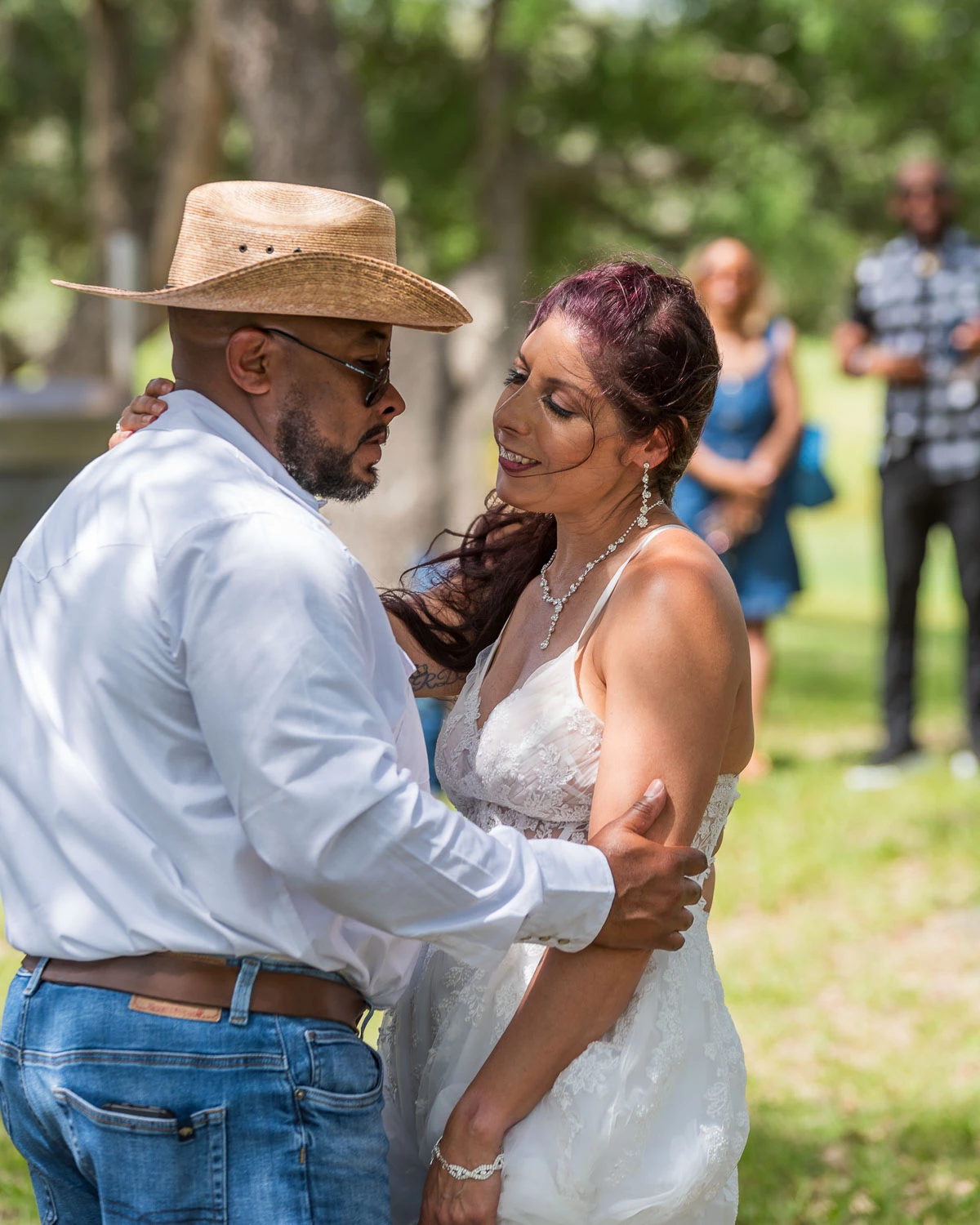

August 14, 2025
After the removal there is an obvious patch where the person was and it looks worse than it did with them there.
Look just behind the groom's shoulder where the DJ has been removed.
