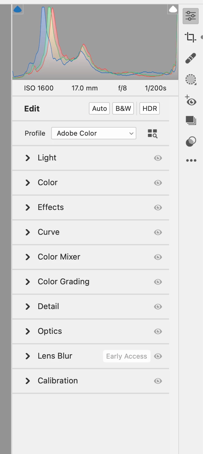

nigel e
Jun 16, 2020 5:15 PM UTC
P: Geometry Controls are no longer a separate panel and have moved to the Crop Panel
Update today to Camera Raw - loaded Bridge to use Camera Raw and can no longer see Geometry Panel

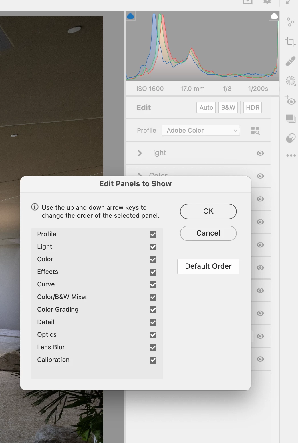

AndresGarcia84
Mar 3, 2024 9:13 PM UTC
The Geometry TAB within Camera Raw (16.2 Mac Os Sonoma) converter is no longer visible. I've tried to "edit visible panels" but doesn't even appear as an option. For some reason can only now find it under the crop tool. Thanks in advance for any suggestion!

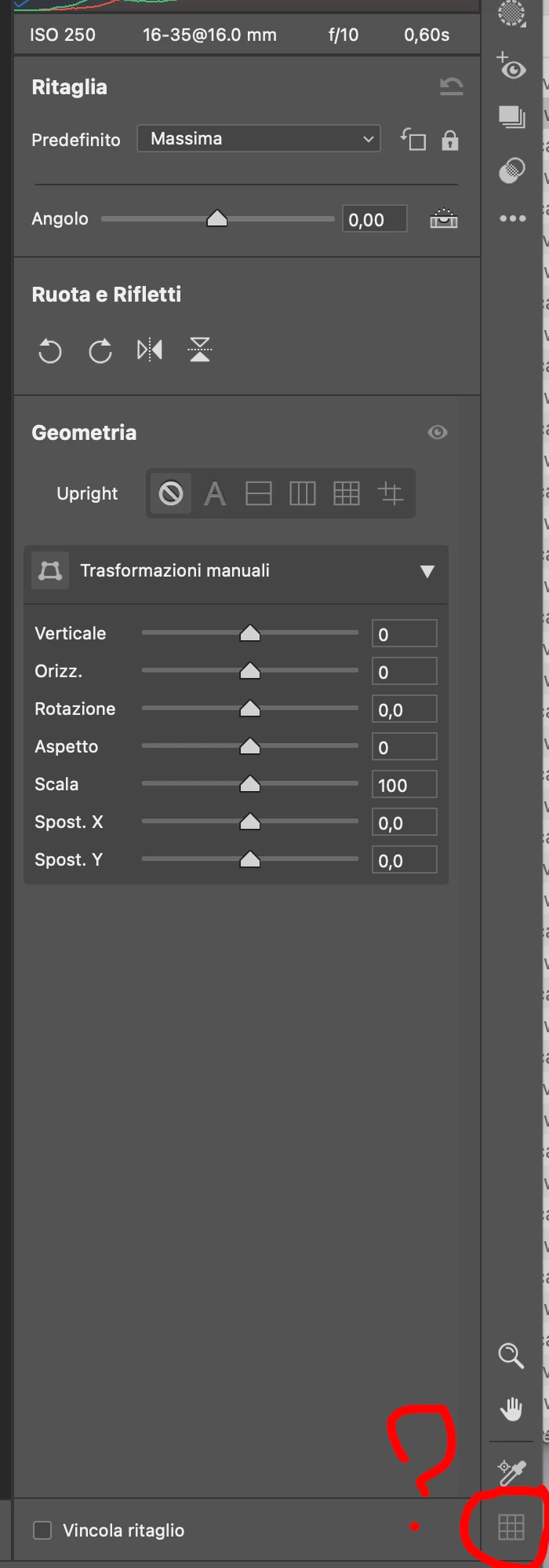

Alfredo Pantani
Feb 28, 2024 8:07 AM UTC
what't the point to put geometry in the crop panel and than not allowed me to use the grid? The geometry is totally useless without the grid!

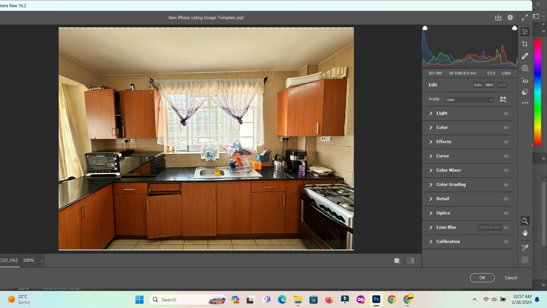

Feb 26, 2024 8:02 AM UTC
I have been using PS 2024 to edit real estate photos shot with a wide angle lens, I have been correcting the photos using the "Geometry" feature from the Camera Raw filter, but as of this morning the button has disappeared. Kindly assist?
Erik Bloodaxe
Feb 26, 2024 4:49 PM UTC
Its moved, look in the Crop Panel.
