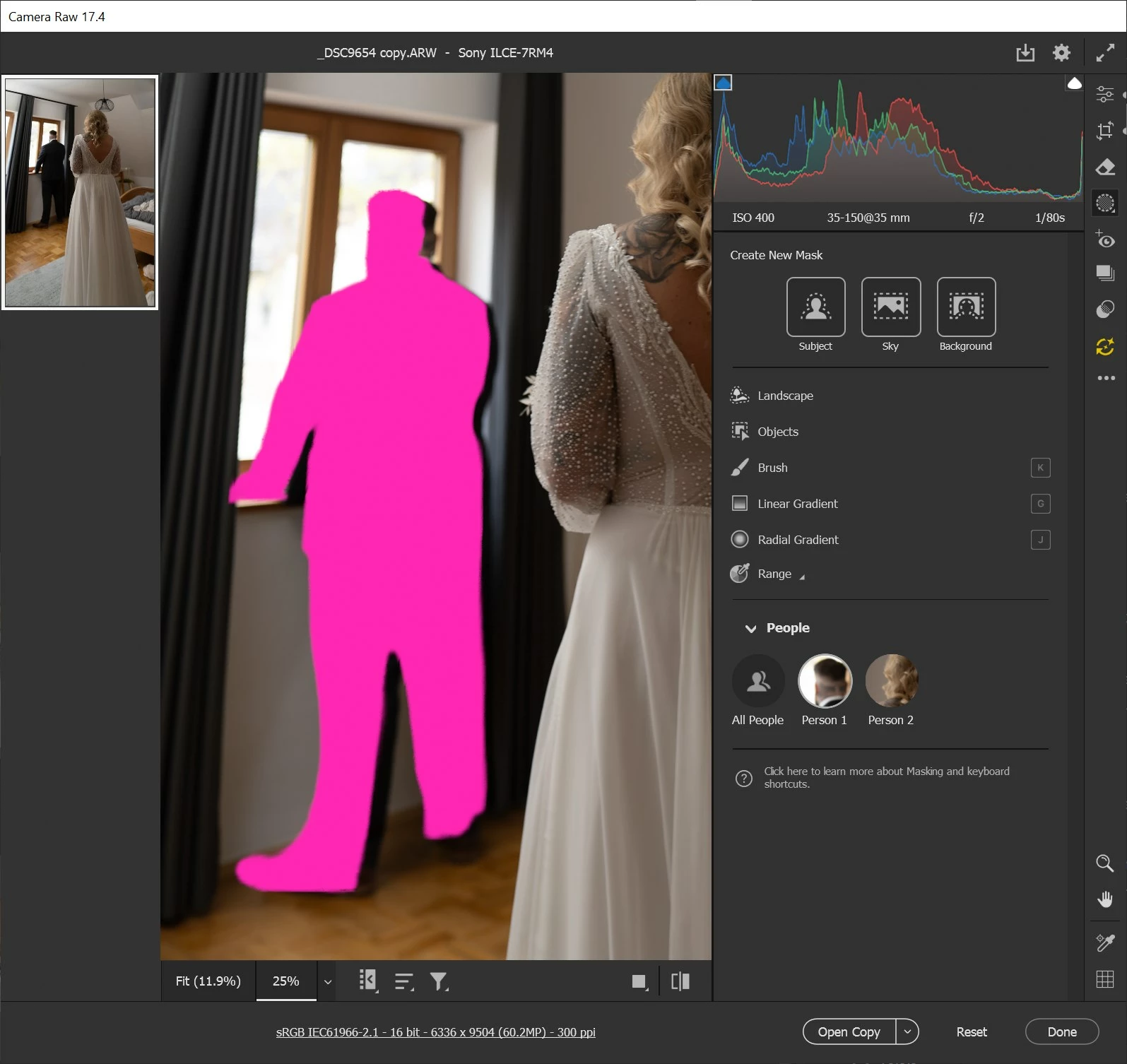

People Mask Offset when Geometry adjustment applied
In an image with geometry adjustments (Geometry/Guides) the mask of a person is shifted to the left, see image.
David Franzen at Work
Jun 26, 2025 3:30 PM UTC
Do you see the icon button highlighted in yellow in the Camera Raw toolbar in your screenshot? If you click it and then use the "Update All" button in the AI Edit Status dialog, does that fix the mask?
testerusAuthor
Jun 26, 2025 4:59 PM UTC
Yes, the mask is in the correct possition when I allow it to update generative expand. But I prefer the original expand and the mask is not in the expanded area.
I see no reason why the masking should be restricted by this.
Jun 27, 2025 3:29 PM UTC
Can you send me a raw file with settings in the state they were in _before_ you use Update All? This will help me understand the problem better.
