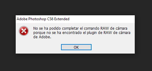

Plugin de camera no detectado en PsCS6
Quisiera saber porque me aparece esto al querer activar mi camera Raw: " No se ha podido completar el comando Raw de camara por que no se ha encontrado el plugin de RAW de camara de Adobe ", teniendo ya instalado mi camera RAW (v.9.1). Tengo Photoshop Cs6. Hasta intente con camera raw v.10.  De ante mano gracias.
I would like to know why I want to activate my Raw camera: "The Raw Camera command could not be completed because the Adobe Camera RAW plugin was not found ", having already installed my RAW camera (v.9.1). I have Photoshop Cs6. Even try camera raw v.10.  Beforehand thank you.

Camera Raw version 10 will not work with Photoshop CS6. The latest version that will work with that version of Photoshop is 9.1.1 If you installed version 10 it's possible that is your problem. You will have to remove that version and reinstall 9.1.1 in order to get Camera Raw to work. If that version does not support the raw files from your camera then your choice is to use the free DNG converter from Adobe to create DNG copies of your raw files that can then be opened with Camera Raw 9.1.1.
