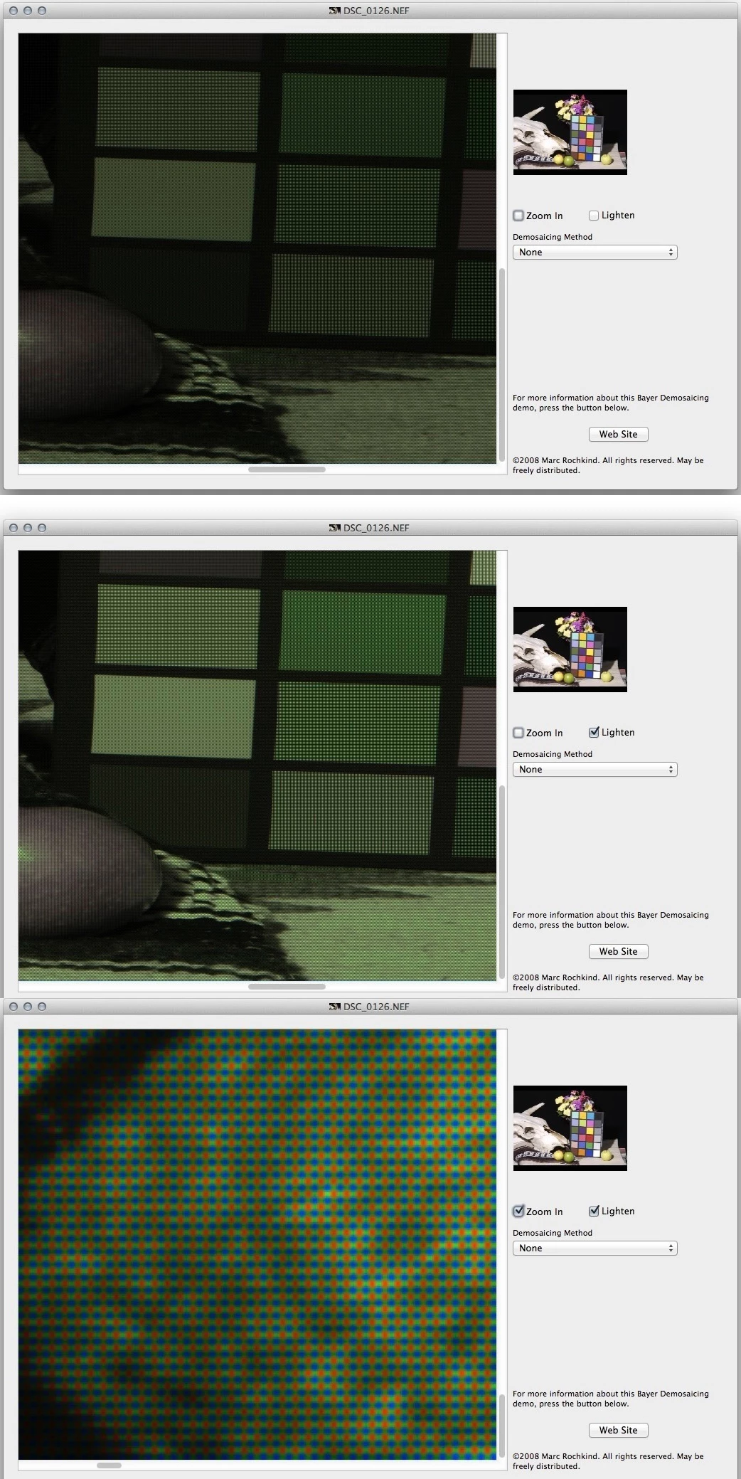

The raw isn't rendered, it looks like this in reality:
Are you saying that the rendered image in Photoshop from ACR looks lighter than the embedded JPEG or what you see on the back of the camera?
That isn't the raw, that is simply one interpretation of the raw from the camera made into a JPEG preview.
