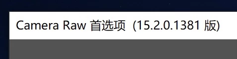

Camera Raw: 15.2 version on Win 10
Bug: please compare the two files and adjust the high lights, they are not on the same range
I’ve been using Fujifilm X-H2s for a few months, I did a few times of time lapse, I found the raw files sometimes were not on the same exposure, I thought it was the camera’s problem or my wrong operating, until then, I picked the two files and sent to my friend who is using Mac system, and he showed me they were on the same range. Even I asked another friend to try on Win System, he got the same situation, so now I am reporting this to you, any problem please send me Email, <Removed for Privacy>, thanks.

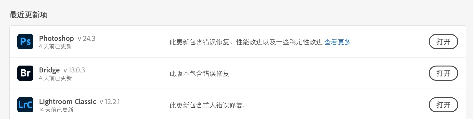

Hi @MATTHEW28594348e9jk curious if you have noticed any change with the recent update, 24.3?
Mar 28, 2023 5:01 AM UTC
Hi @CShubert till didn't be fixed, Matthew
