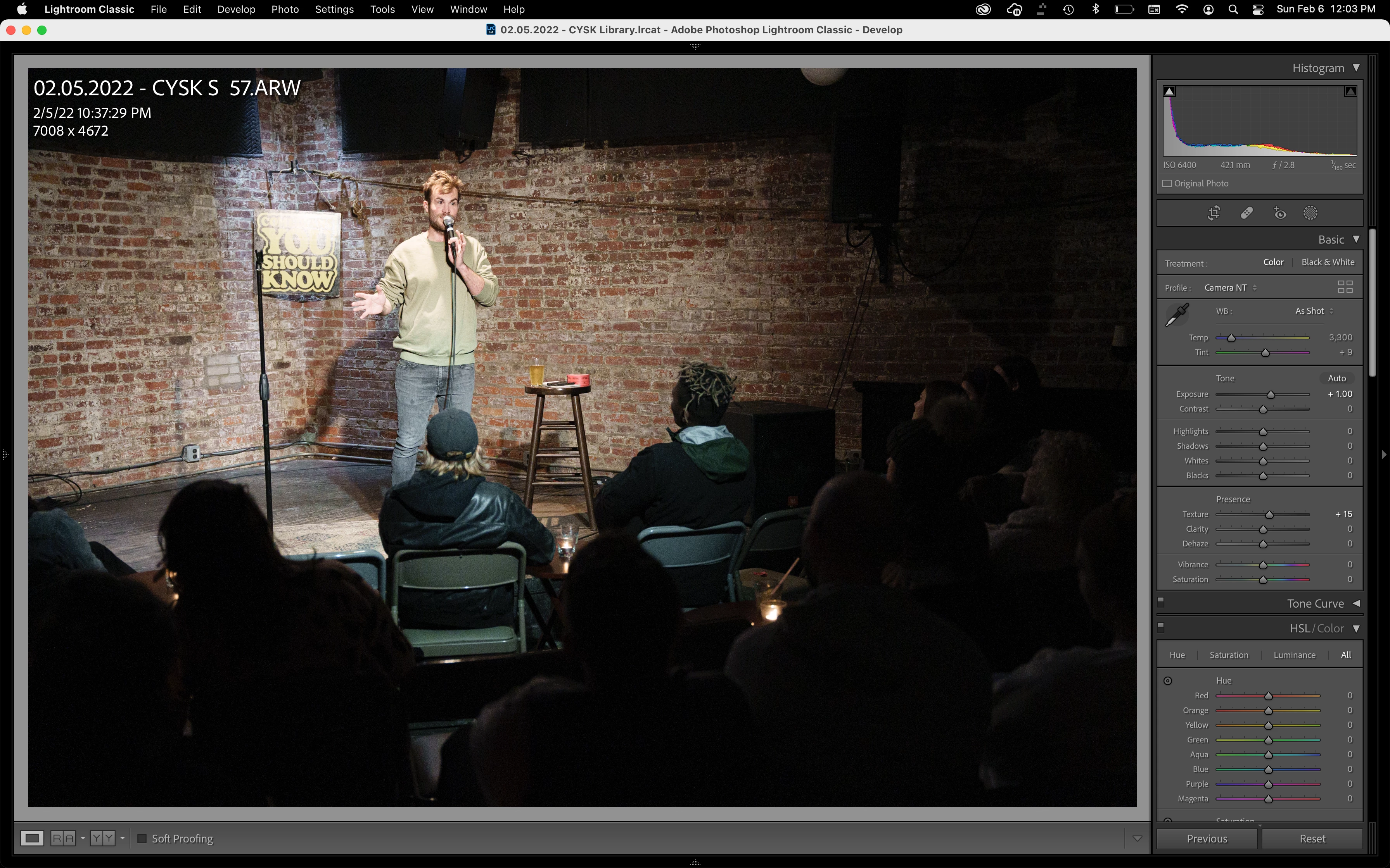

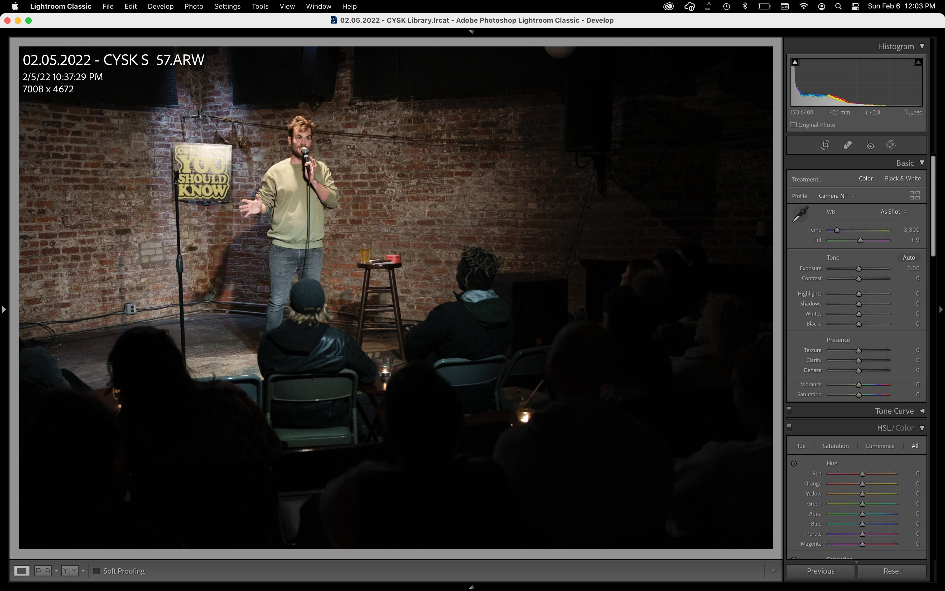

I bought a Sony A7iv in December and I have had constant issues editing photos in lightroom/camera raw. I am running the current version of camera raw (11.1 Camera Raw 14.1) and shooting uncompressed raw files in the camera. The issue I'm having is whenever I add clarity or boost the shadows or boost the exposure, I begin to get hundreds of white pixels in the shadows of the image to the point of being unpublishable.
I've made sure I'm not shooting in any picture profiles and DRO is off in the camera.
I've called both Sony and Adobe support. Sony had me open the raw files Imaging Edge - their proprietary software - and the issue didn't show up so they told me the won't help me. Adobe said can't do anything but the issue might get resolved whenever camera raw is updated. As a final test, I opened the images in Capture 1 and the white pixels aren't their but the image is so soft I wouldn't consider the image usable.
I've attached screen captures and a .jpg export of an example. You can see the adjustments I make to the image on the right side of the screen capture.
I've read online that some people had the same issue with the Sony A7iii and ended up returning is because the issue was never fixed. I'm a full-time photography that was planning on transition from Fuji to Sony but this is a serious issue that make this camera essentially a brick.

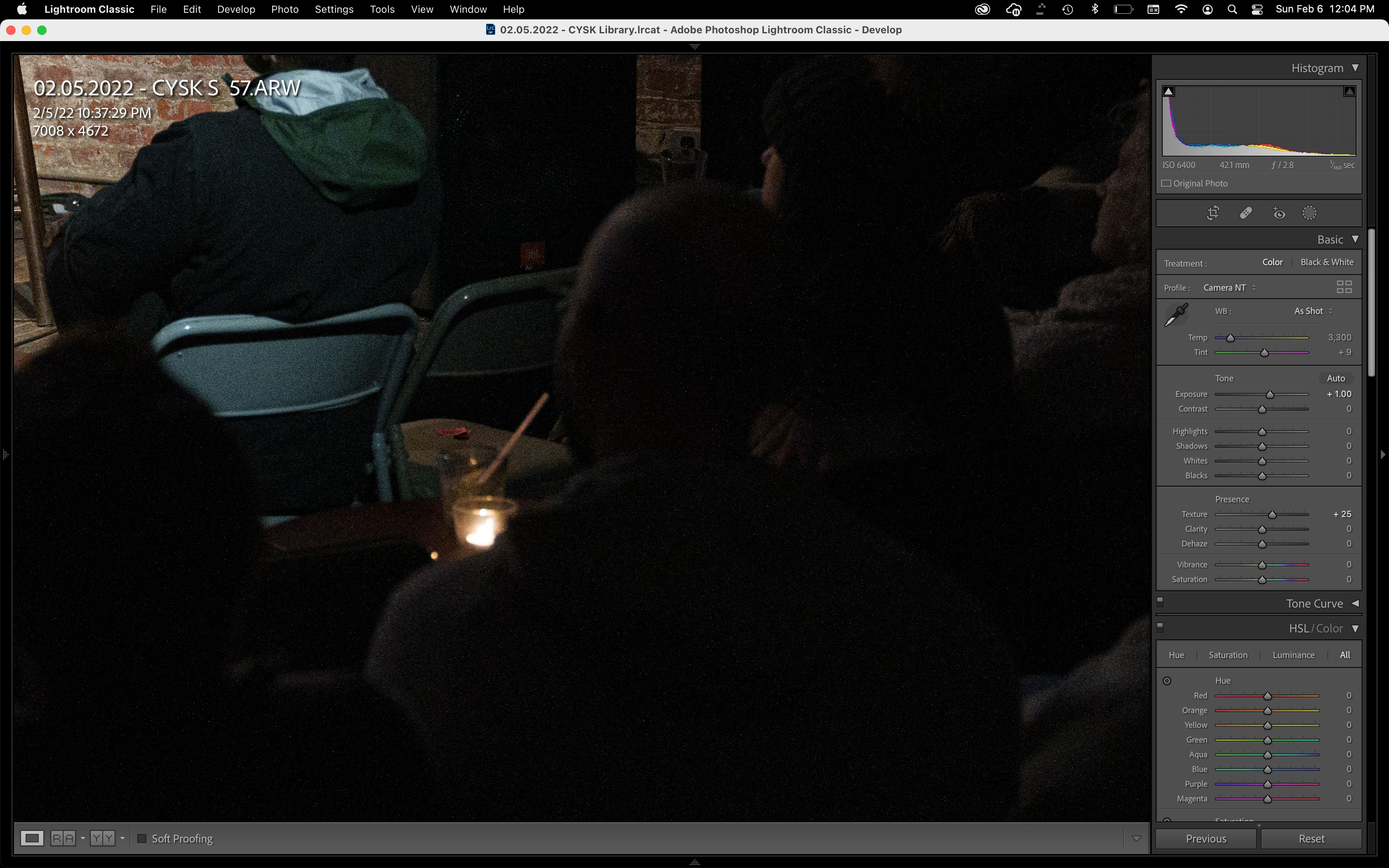

I've seen that post and pixel remapping doesn't do anything to resolve the issue. The issue isn't white pixels/spec/dots appearing on the image SOOC (straight out of camera), the issue starts whenever I make an edit - boost the exposure slider, add clarity, boost the shadow slider, etc... - a massive amount of white pixels effect the shadow area unlike anything I've seen on a digital camera from the last 10 years. This issue makes editing or post-processing files impossible because the shadow detail falls apart almost immediately after making any adjustments.
Here is an example of how it could effect a different type of photographer. If a product photographer wants the backdrop of a product to be true black while the product is properly exposed (so the exposure of the image isn't "ideal" but the desired exposure of the photographer). They take the photo, bring it into a raw convert, add +20 clarity and suddenly the backdrop area is covered in white pixels that weren't visible before the edit of +20 clarity. The image looked normal SOOC (straight out of camera) but any edit will cause a dramatic degradation in image quality to such an extreme point there is something clearly wrong with either the camera or the software.

The amount of white specs/pixels makes publishing anything shot at 3200 ISO or higher that requires post processing impossible. Either I need to apply so much noise reduction my image is soft or the shadows are covered in white snow. There is an issue with the way adobe is processing Sony A7iv files or my camera is defective.

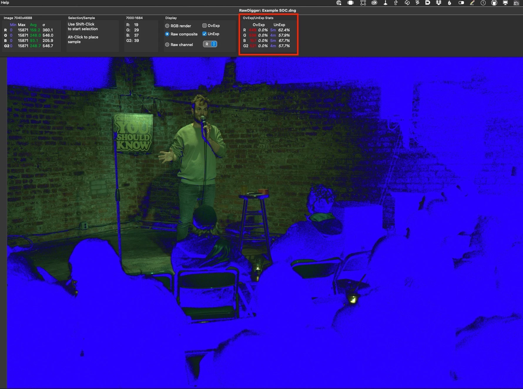

First issue is, the raw is really very under exposed and shown in RawDigger below. This is the primary reason you have so much noise.

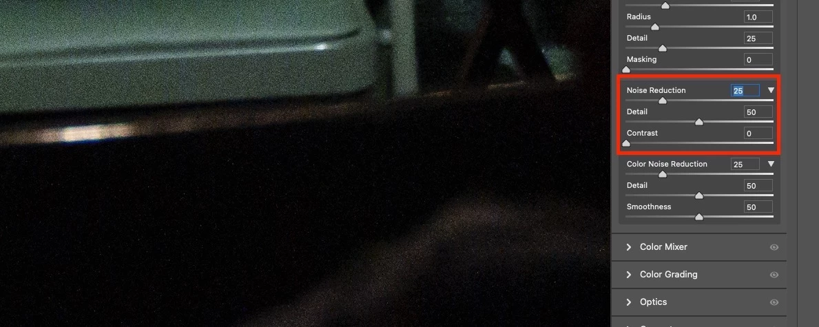

As for the white specs (dots), I see them with your settings but you have Color Noise reduction on, but none for Noise Reduction above it which removes those white "dots' of noise, as seen below (set to 25).
I think you might try other such settings and see if you prefer this, but really providing more actual exposure will go a long way towards getting less noise, if at all possible (I realize in this condition, the light level is very low).
RawDigger with blue overlay of under exposed pixels:

My settings with NR set to 25:
Without you having a test of another camera with the same settings, I can't say that this is 'normal' for your new camera or not. But there are settings that can reduce the 'white dots' in Lightroom Classic.
