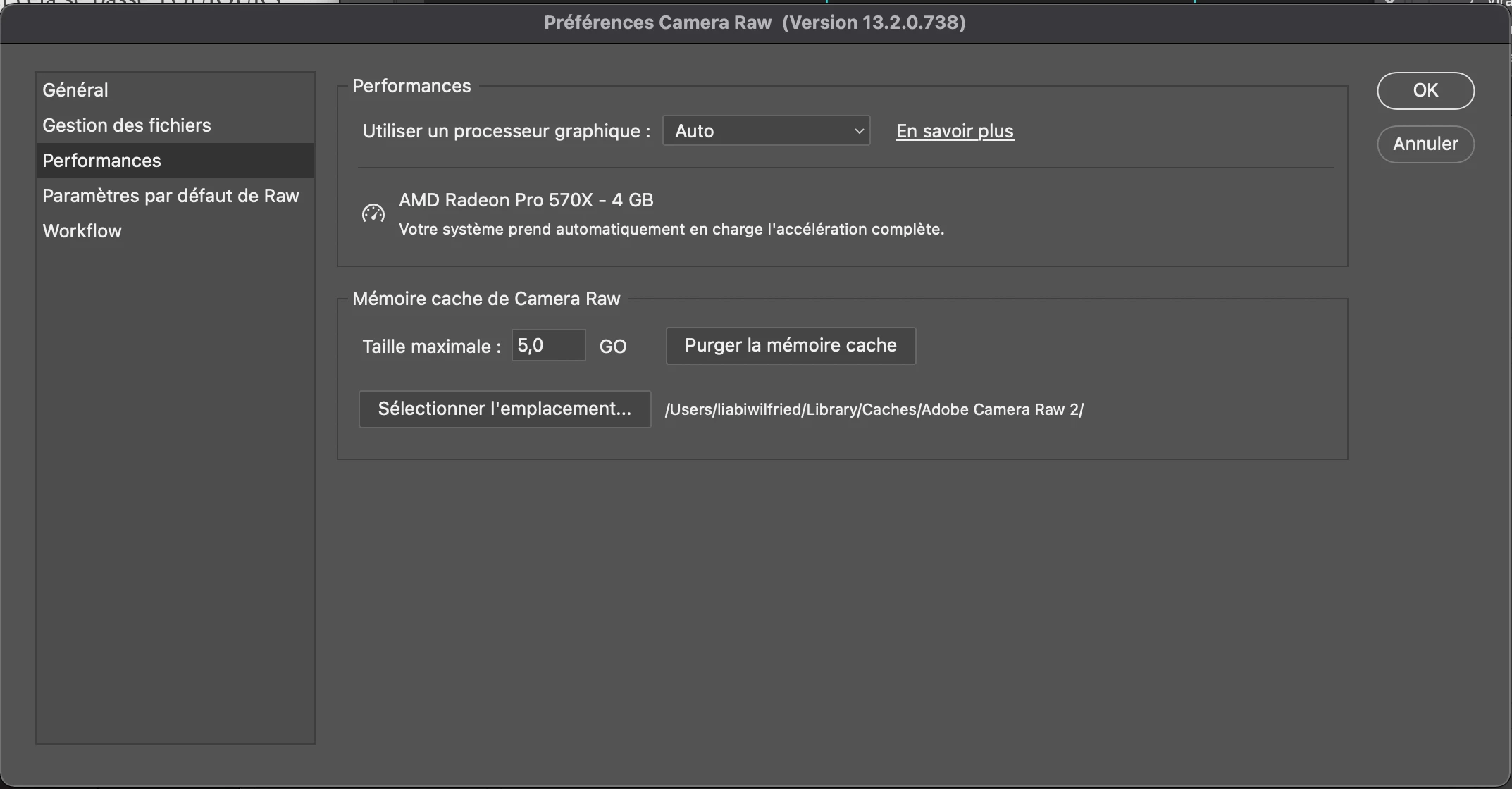

Hi, I guess this one: Photoshop > Preferences > Camera Raw > Performance and selected Off from the "Use Graphics Processor" drop-down.

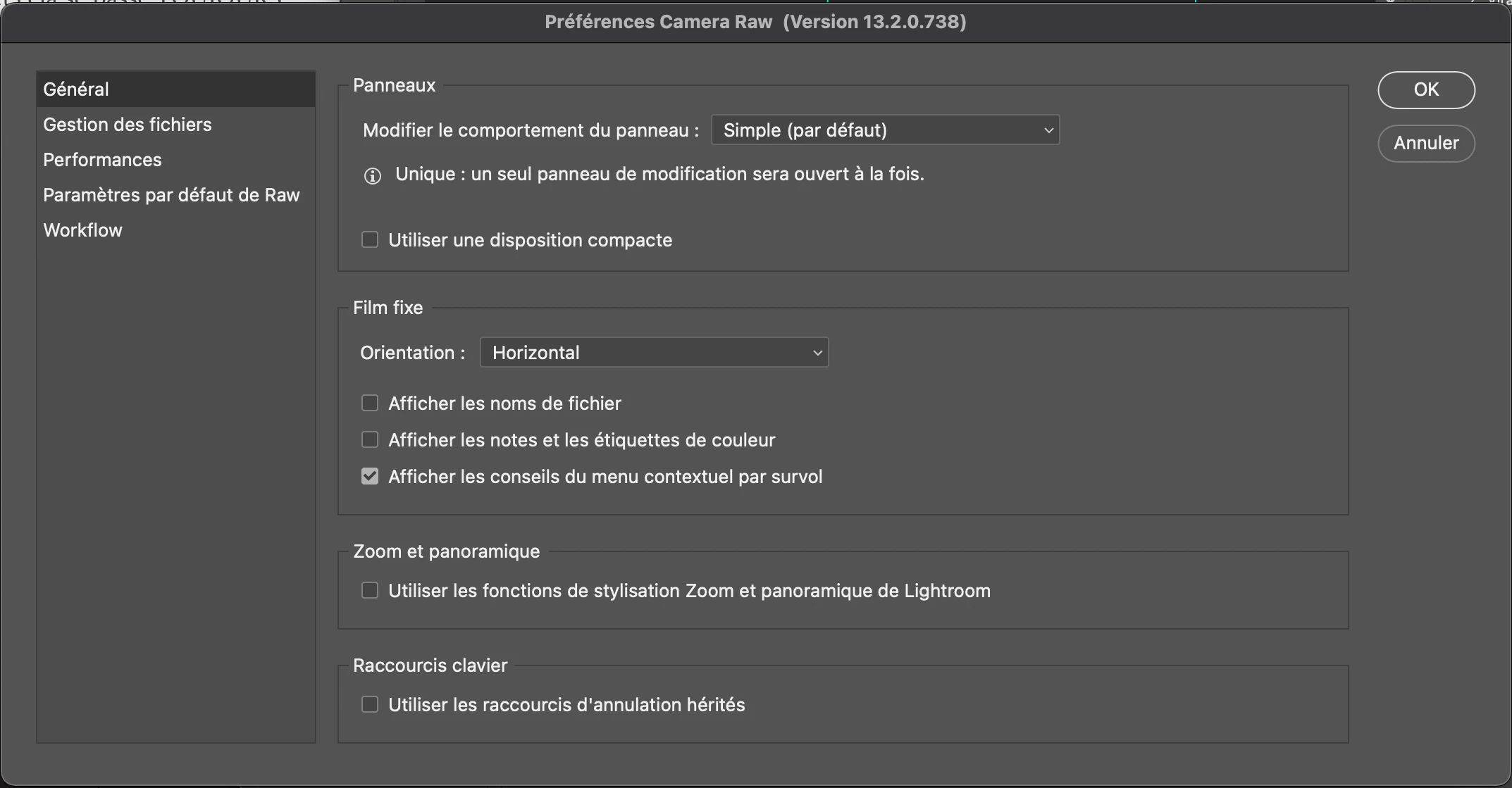

Apr 26, 2021 9:52 AM UTC
I find one more solution, this my camera raw config.

This just worked for me. After force quitting and re-opening Photoshop, I went to Photoshop > Preferences > Camera Raw > Performance and selected Off from the "Use Graphics Processor" drop-down.

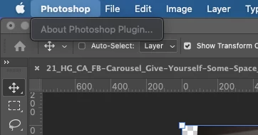

I have some good news, potentially.
I think by now we have realized that Adobe doesn't care about it's customers and or it's product and only cares about our money since we have reiterated this issue over and over and over again with the only result being the confirmation that Adobe's staff is completely and utterly USELESS. Unless you ask them for a refund of your subscription, which I did and I was successful in doing so - that is what this has come to, yes, so go for it.
However, I had this same issue pop again yesterday and I seemed to have resolved it.
First of all, I am now saving all of my work on my desktop for easy access and assurance that I have saved it and for recovery purposes. On my third photo I was editing, I had done all edits for about an hour, converted layers to smart object and opened Cam Raw and the dang progress bar showed up again. (By the way I also got on with support via phone and Adobe could not resolve it) This was about the 6th instance this progress bar popped up now so I had some restraint and tried to see if I could click anywhere...well I could and it was at the top menu bar (on my Mac) next to the Apple symbol it will say "Photoshop". If you hover over that it will only have one option when this stupid progress bar is up and it says something like "explore Plugin" if you click that then click around the page, and hit cancel a few times, it seemed to resolve the progress bar and I was able to continue working. I did this twice with success.
I hope this helps!
