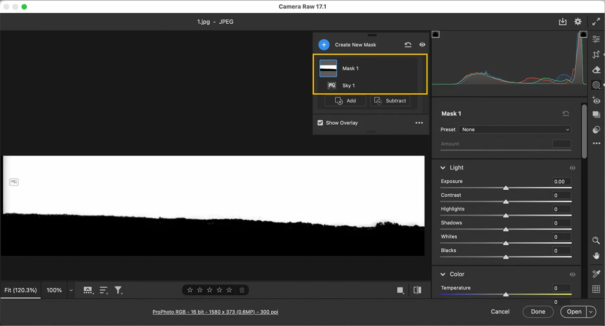

1. Do a quick Sky mask to take care of all of that.

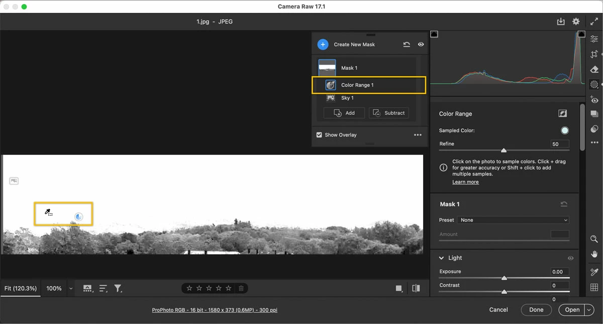

2. Add a Color Range mask. I did not click the Color Range sampler, I dragged it to include more colors in the sample for a more solid selection of the cyan area. However, those colors had too much in common with the foreground trees, so…

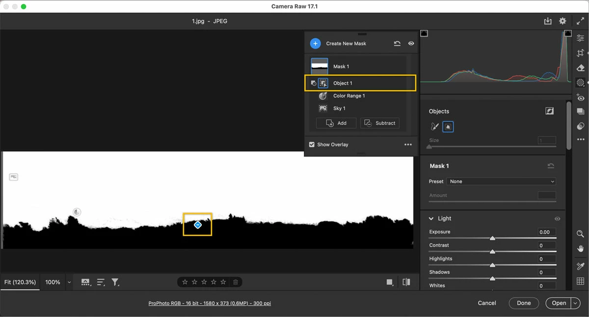

3. I did a quick Subtract by dragging an Object Selection tool rectangle around the foreground. This is pretty good, but some parts of the cyan area are still not masked, so…

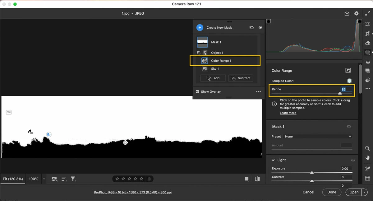

4. I returned to the Color Range mask and adjusted its Refine option.
Now there are only a few little bits left that can easily be picked up by a brush mask.
