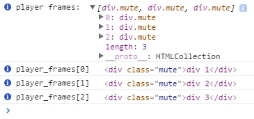

    Which browser is this? Your code works perfectly fine for me:
    getElementsByClassName - JSFiddle
    Output in Chrome on Win7:
    Just a quick note, I ran it in an inline executed function (e.g. (function(){})()) to delay the execution so the DOM could build. The scripts from services are typically properly appended to the bottom of the <body> so HTML should exist but you might want to consider making sure your content is present before trying to work with it. From your screenshot however, it appears captured properly. And you didn't start off on the wrong index, you started properly at 0 not 1. So I'd be very curious what your browser is, or more importantly, if you have a bunch more code than this example that might be interfering with your results.
