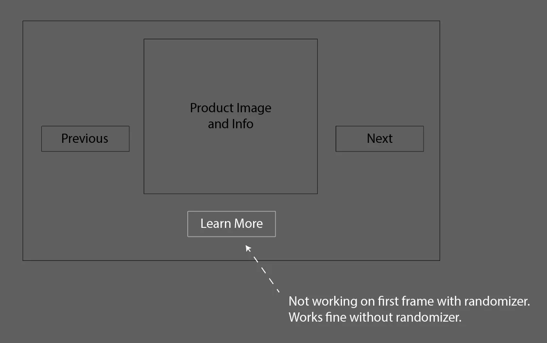

Hi everyone,
First time poster, and I've run into a weird problem with the randomizer that I can't find the solution for through google. I'm creating a product slideshow banner with 5 frames total. It will have previous and next buttons, and each frame will have a ClickToGoToWebPage button leading to the product's page.
The slide and buttons work great, with and without the randomizer, but I have noticed that when the page initially loads, the first frame's button to the webpage does nothing, no matter how many times I click on it. If I scroll to the next slide with the previous/next buttons, then all the buttons are fine.
It's always the button on the first slide that doesn't seem to work with the randomizer. I know it's the randomizer, because without it, the button on the first frame works as it should.
Does anyone have any tips on what I should check?
Here's my code from the first frame, and I've attached a crude screenshot, if it helps!

    Liam Dilley
    May 18, 2021 11:54 PM UTC
    This for a web page?
    If so why does the button need to be scripted and not just a html anchor?
    issashaAuthor
    May 12, 2021 3:19 PM UTC
    I guess I should have noted that this is for Adobe Animate!
