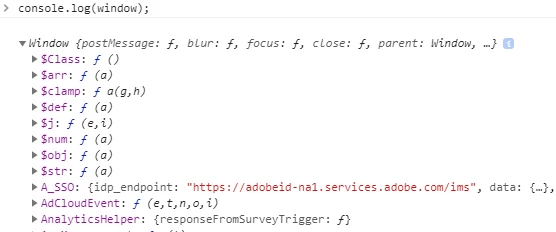

Overall to get better feedback on what is going on, open your browsers developer panel (different way in each browser but for example in Chrome it's Triple Dot->More Tools->Developer Tools or CTRL+SHIFT+i on Windows for example). Inside this panel you can easily inspect values, better than alert(). There are a bunch of tabs across the top of the panel with different tools such as Elements, Sources, Console (where I'm referring to), etc..
If you open up Developer Tools and select the Console option, using the JS function console.log(anything) will output whatever you drop inside it into your console. Much better, complex objects, properties and values can be examined far easier than alert(). You can also type code directly in the console to give it a try, e.g. console.log(window);
Try to use that on all the errors, data returned, data being sent, etc. It should help you diagnose things far easier.

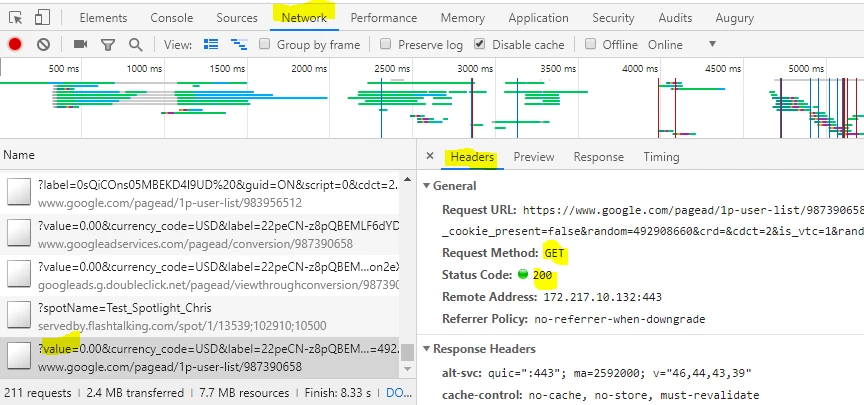

Use the "Network" panel inside the Developer Tools. It might seem a little complicated at first but it's straight forward. Find your AJAX request and examine the request and response. Since this is on the same domain (that I know of) there probably won't be a call for "OPTIONS" which returns the available request types (GET, POST, PUT, DELETE, etc).
Try changing the method you're using to GET and see if you get that error. e.g:
