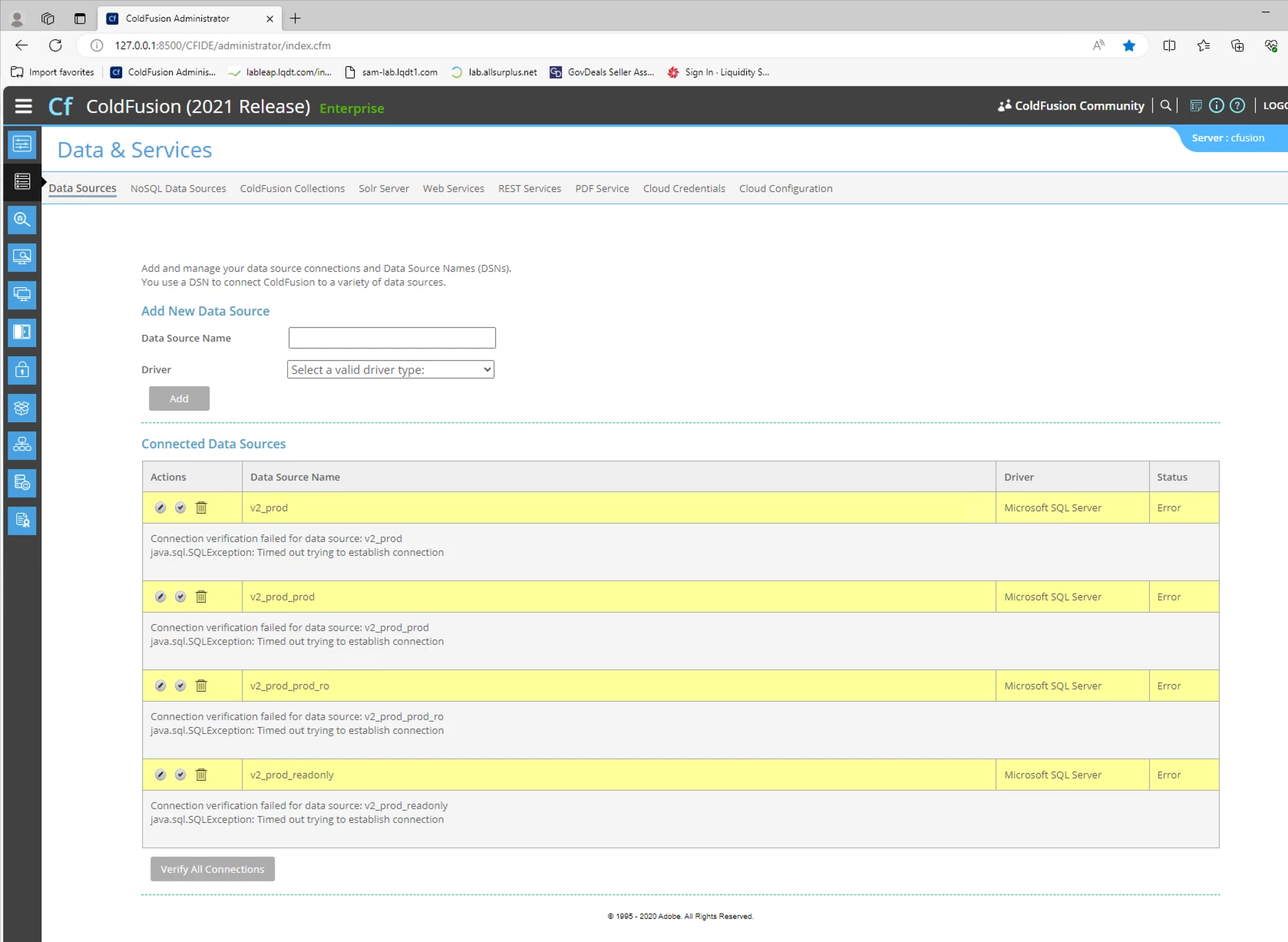

13) Check my sites. No joy. Validate my data sources in CF Admin. No joy. Immediate eror message that the connection timed out. Add a new datasource suing the same details. no luck.

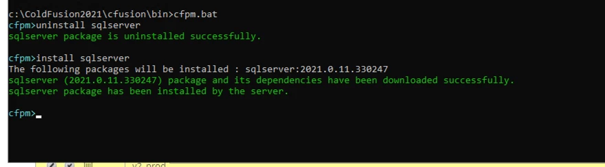

18 ) run cfpm.bat uninstall sqlserver, let it finsih then run cfpm.bat install sqlserver. restart coldfusion.

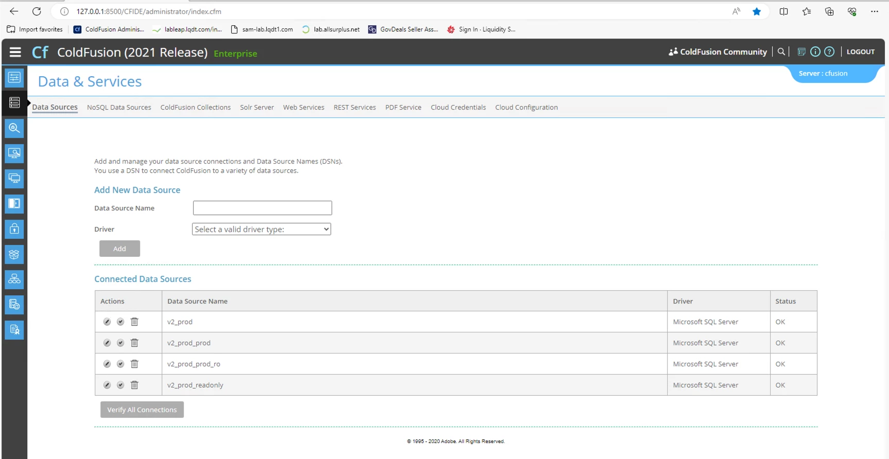

3) car file imported. WITHOUT restarting CF I check the data sources , they look good (is it a mirage?) -- screenshot 1 labeled DataSources-After-Car-Import-New-Install.png
4) Since @Charlie Arehart suggested it, I restarted CF after the car file import and checked the Data sources. This time they dont validate. Screenshot labeled after-RESTART-of-CF.png

6) Lets reinstall the sql sever package and restart cf and see what happens. screenshot labeled reinstall-sql.png - resintalls fine.

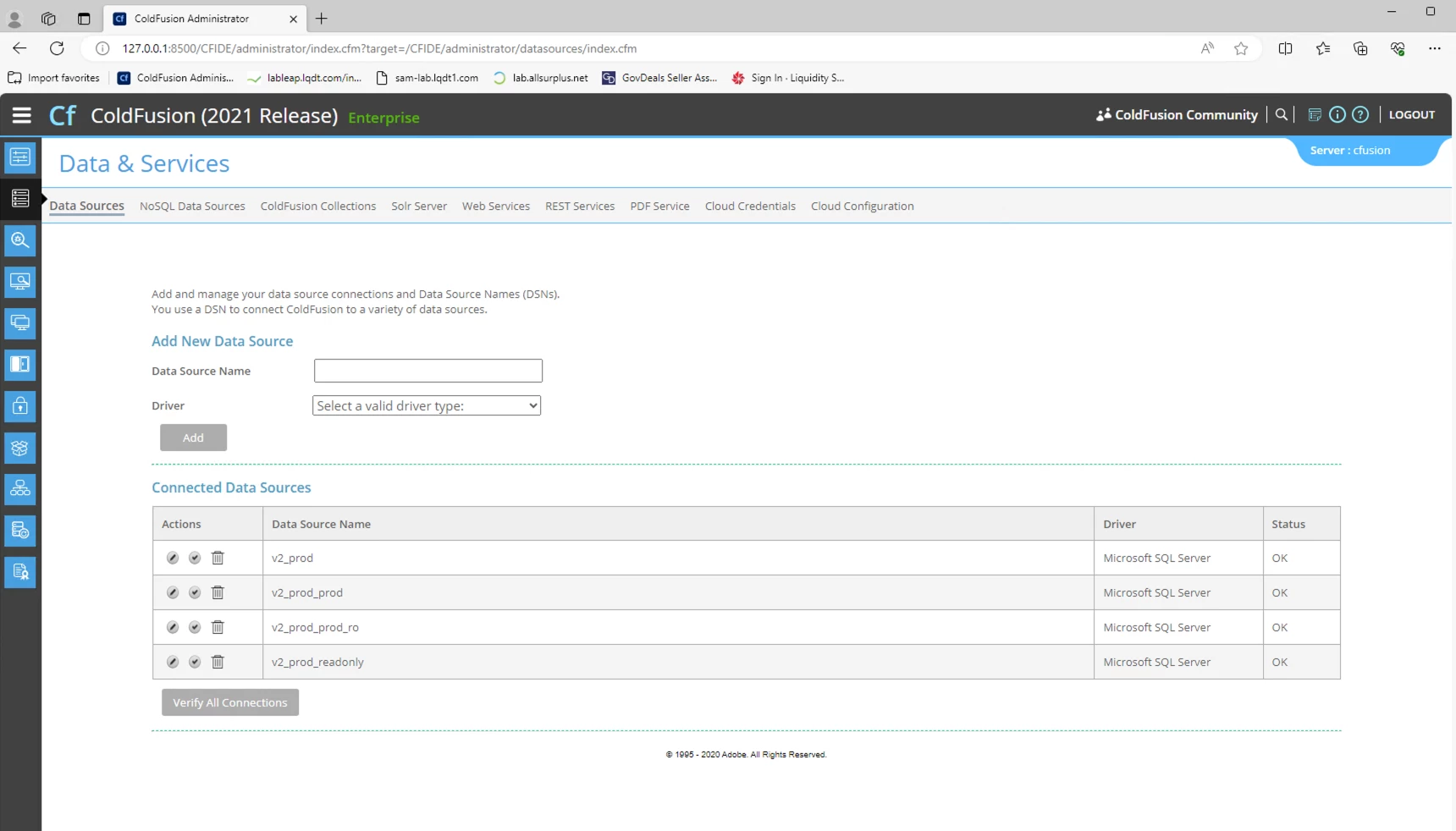

7) Restart CF and check datasources - and they work. screenshot labeled working.png 🙂
