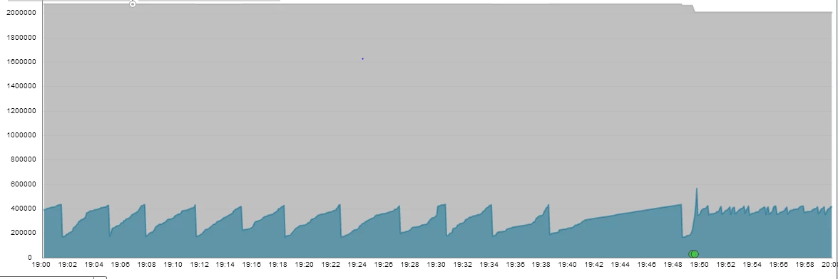

Here's the JVM memory usage from the hour of the crash (green dots at the bottom indicate the server restart)
The ramp up without any garbage collection is the same thing we saw the last time the server crashed as well. I have the Fusion Analytics logs from the latest crash, if anybody would like to see a specific chart.
Any suggestions would be greatly appreciated. Thanks.
