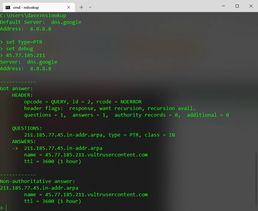

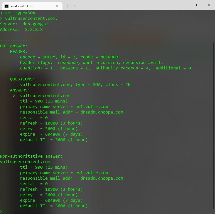

    For the first question, to find out more about any IP address, you can use standard IP network tools like nslookup, dig, and whois. When I use nslookup like in the first attached screenshot, with "set type=PTR" so I can convert an IP address to a DNS name instead of the other way around, and with "set debug" so I get more complete information, it tells me that the PTR record for 211.185.77.45.in-addr.arpa resolves to 45.77.185.211.vultrusercontent.com. Then when I did an SOA search in nslookup for vultrusercontent.com. (the . at the end is important to include actually, see the 2nd screenshot), it told me the authoritative name server was ns1.vultr.com among other things. Anyway, I don't get anything when I try to connect to the IP address and port using a browser or openssl, so my guess is that (a) this isn't a legitimate server, and (b) this is part of a way for an attacker to collect data from your server and send it back to the attacker.
