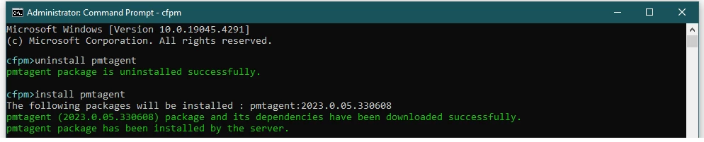

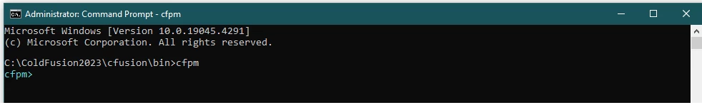

    Try to uninstall the pmtagent package, and then reinstall it. There now follows an example. (I shall assume that your ColdFusion version is 2021 and your Operating System is Windows):
    Open the command prompt (CMD) as administrator. Use the DOS command CD to navigate to C:\ColdFusion2021\cfusion\bin.  Type cfpm and press ENTER. The cfpm promt should then appear.
    Do the following in succession:
    • Type uninstall pmtagent and press ENTER.
    • (when the cfpm prompt reappears) Type install pmtagent and press ENTER.
    May 8, 2024 7:32 AM UTC
    I have installed ColdFusion Standard 2023. I already reinstalled a few times. The error keep coming out.
    May 8, 2024 7:42 AM UTC
    In addition, I already updated ColdFusion Standard 2023 release 7 from release 5.
