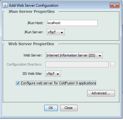

Hi Carl,
Thanks for your response.
I had created a web site named "vfqcf" in IIS and configured the web server using WSCONFIG (C:\JRUN4\BIN\WSCONFIG.EXE) by running it as administrator where I selected jRun server and iis website as newly created server instance. Please find the attached screenshot.
Please let me know if you  need any more info.
Abdul
Aug 1, 2017 4:21 AM UTC
Hi Abdul,
I would think if you have your application CFM files in the vfqcf website then CF instance vfqcf would be the one doing the servicing.
Regards, Carl.
