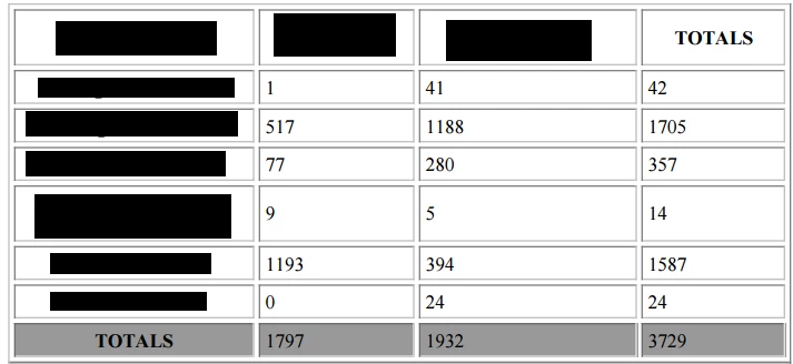

This is the result of what it should look like (currently in CF9). Any help is appreciated!
