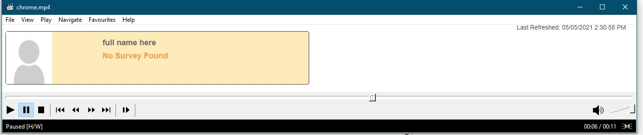

    I downloaded your 2 videos and watched them using Media Player Classic - Home Cinema. At 0.06x speed, you can clearly see the difference. The Chrome image does indeed flicker, and the FF image does not.
    However, I saw something else. Though you talk of "the image", the Chrome movie showed that there are in fact 3 images:
    There is an order in which the 3 images appear in the Chrome movie.
    Image 1 stays fixed, unchanging, throughout. At 3-second intervals (2:30:52, 2:30:55, 2:30:58, 2:31:01), images 2 and 3 disappear simultaneously for an instant, then reappear.
    But they don't reappear simultaneously. Image 2 reappears a fraction of a second before image 3. In fact, at 2:30:58, you can see only images 1 and 2:
    This leads me to think that the difference in behaviour between Chrome and Firefox might be due to a difference in their caching.
