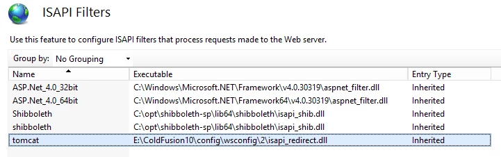

Calling LoadLibraryEx on ISAPI filter “E:\ColdFusion10\config\wsconfig\2\isapi_redirect.dll” failed
Why am I getting this error when I've used the wsconfig within my "site-name" folder to bind my site to ColdFusion? It keeps looking for the isapi_redirect.dll inside of wsconfig\2\ instead wsconfig\1\ folder. Where do I look to make this correction?
2Charlie
2CharlieCorrect answer
Dec 1, 2015 2:26 PM UTC
Where is this tomcat set? Its entry type is showing as inherited.
It seems I have to delete the wsconfig folder and recreate the coldFusion instances. There seemed to be some corruption or misconfiguration in one of the wsconfig folder.

Whats in ColdFusion11\config\wsconfig\wsconfig.properties file?
HTH, Carl.
2Charlie
2CharlieAuthor
Nov 22, 2015 11:34 PM UTC
This is what is showed.
#ColdFusion Web Server Configuration File
#Fri Nov 20 16:32:01 CST 2015
1=IIS,2,true,"",bitness64
1.srv=localhost,author
Nov 22, 2015 11:59 PM UTC
This part "1=IIS,2" - two here says refer to  ColdFusion11\config\wsconfig\2 for ISAPI information.
Perhaps make a copy of wsconfig\wsconfig.properties then change 2 for 1. Restart IIS to re-read properties files.
