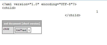

and finally the output that my test script (caller.cfm) generates:
<?xml version="1.0" encoding="UTF-8"?>
<child>
1
</child>
As you can see, most of the xml content is missing.
Calling the function directly (/webservice.cfc?method=testFunction) works quite well, thats why I suppose that the webservice call causes the problem.
Does anybody know what the source of the problem might be? Or ist maybe a known bug?

Feb 27, 2014 10:16 AM UTC
Array and XML may be universal complex types, however, I would never trust that ColdFusion's proprietary interpretation of these types would work outside the CFML language. That is, if a ColdFusion function returns an array or XML, I would not presume it will be interpreted as such by a Java or PHP program, for example.
The most common, universal way of implementing XML webservices in ColdFusion is to use returntype="string". Another, not so common, way is to construct a SOAP response.
In any case, you should report your findings as a bug. If ColdFusion cannot handle the XML, it should return an error message, instead of an edited version of the XML.
