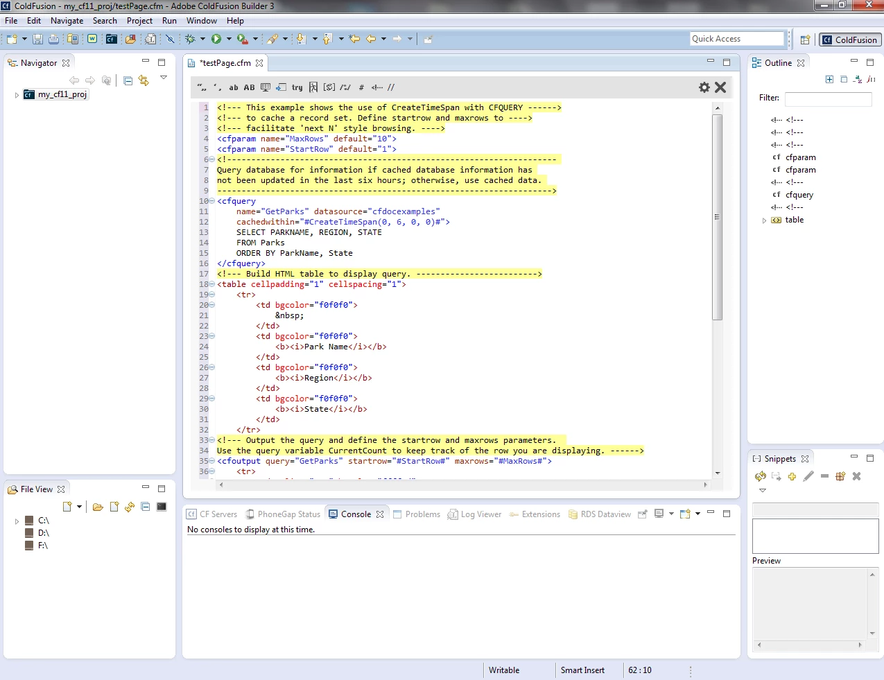

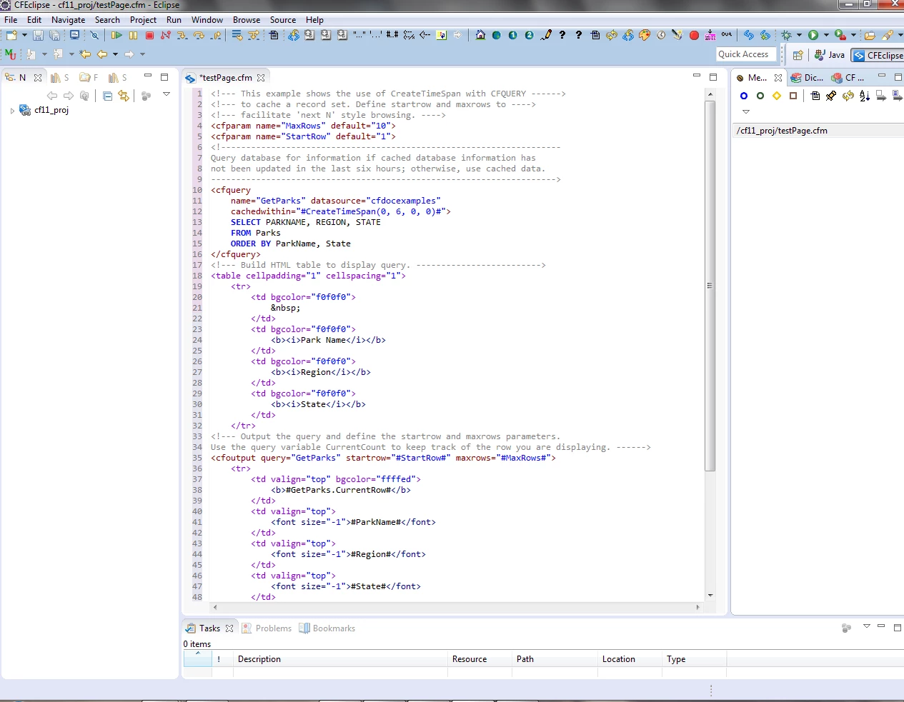

    There are a number of specialized editors to help you develop CFM pages. Chris Tierney's blog article, "What is the best IDE for CFM", presents a comprehensive list.
    To my mind, the two that developers most frequently use are CFEclipse and Adobe ColdFusion Builder.
    Image of CFM code in CFEclipse:
    Image of CFM code in Adobe ColdFusion Builder 3:
