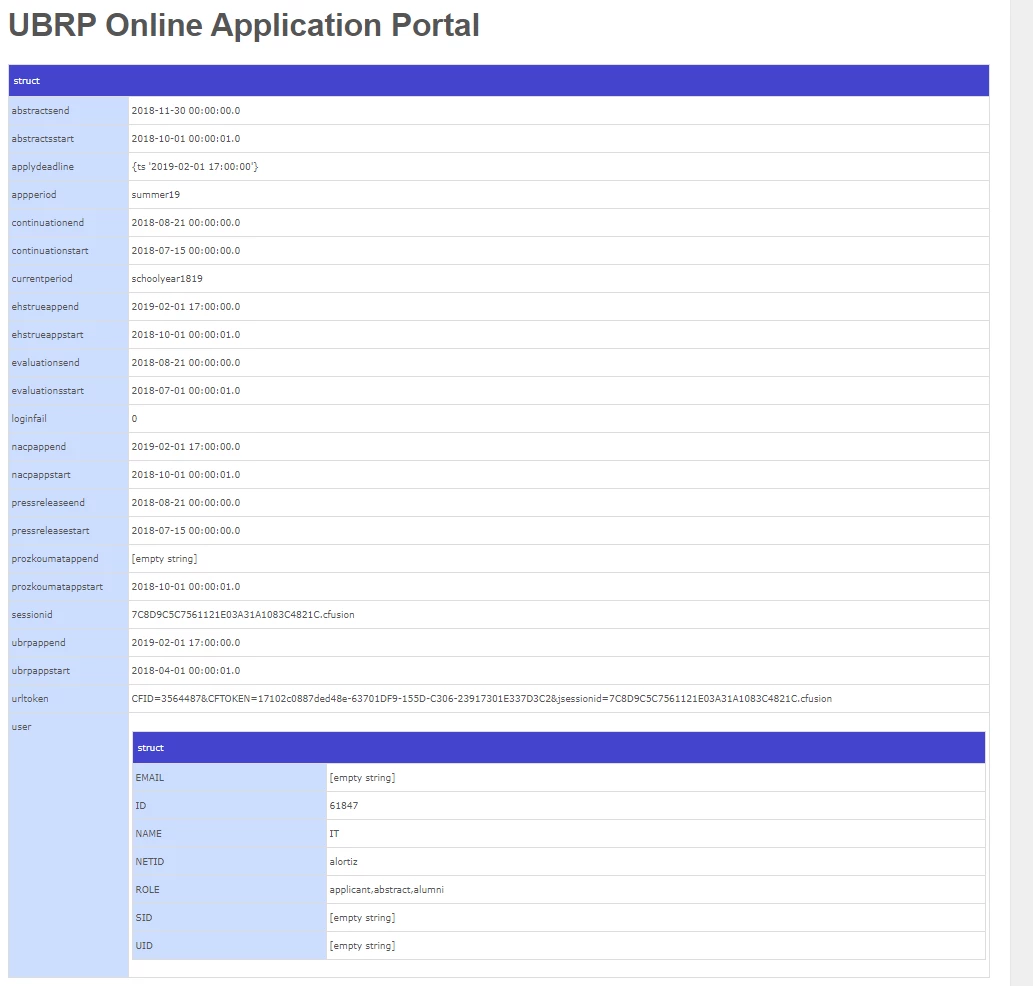

The table "struct" is displaying on the webpage and I can't find in the CF files or wordpress where to hide or remove table(s).  I am not a CF expert or wordpress, but I have experience with HTML.

    There is probably something that looks like this in your code:
    <cfdump var="...">
    Remove or comment that out. To use comments to prevent CF code from executing, you'll use HTML comments with one extra dash on each side:
    bad stuff here
