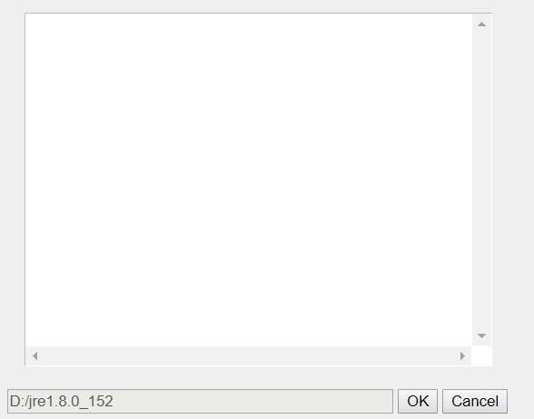

In the CF administrator, I go to "Java and JVM" and then hit "Browse Server" -- on 2 of my CF servers it lists the directories of that server, but on 2 other servers it comes up blank. Anyone know the reason for this? (I am aware I can edit the java config file for this path, but would like to resolve the browse function). Thanks in advance. Image below is the blank screen, which normally has all the drives listed on the server).

    You don’t say what version you are on. In 9 and before, that was a Java feature so rarely worked for most people. In 10 and above, it’s a jquery feature so should work…but it won’t work if the JS for it is blocked from being served from the CF server.
    You should use a browser dev tool to see if perhaps some js files are not being pulled down to the browser.

    Thanks Charlie. It is CF 11. These are newly set up servers and I'm comparing to try to find any difference between the working ones and the 2 that won't browse. I used the "browse" feature on all of them to update the java version after initial setup, then later discovered the two that were no longer functioning. I will check to see if the JS is not running --- good call.
