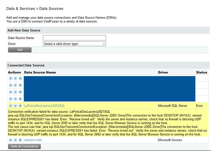

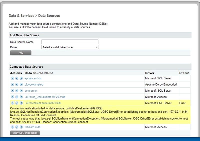

    There are lots of potential problems you can have connecting to MS SQL Server. The problem you appear to be having is a network problem, rather than an authentication problem or an ODBC problem (you shouldn't even need an ODBC driver configured here). Take a look at your SQL Server Configuration Manager and make sure that you have TCP/IP enabled. I don't remember if there are any specific issues with using named instances, but you also need to make sure your instance has a specific port and make sure CF uses that. Ideally, you should be able to plug in an IP address for the database server and a port and it should work.
    I see that you're using Windows authentication, and CF doesn't support that without some additional fiddling around, so you'll have to solve that afterwards. It's easier to configure mixed mode authentication in SQL Server instead (although not as secure).

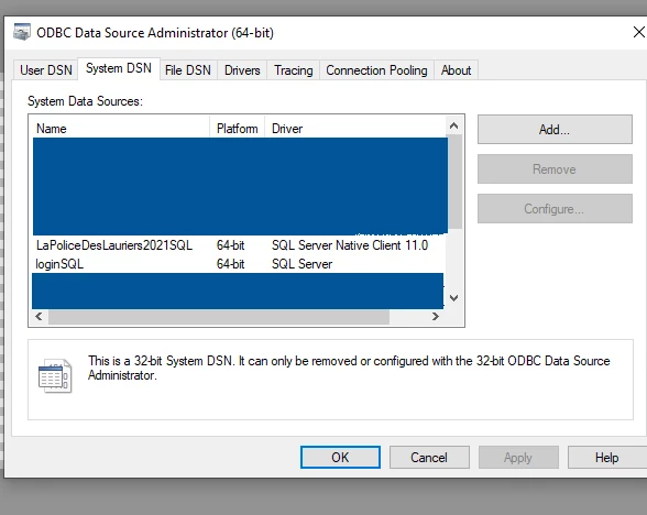

    I agree with Dave: you don't need an ODBC connection. Though I can understand you trying it when other options fail.

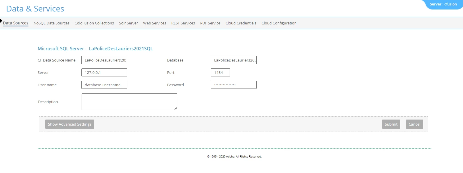

    Suggestion: in the Administrator, click on the "Edit" button next to the datasource "LaPoliceDesLauriers2021SQL" edit the settings as follows
    CF Data Source Name: LaPoliceDesLauriers2021SQL
    Database: LaPoliceDesLauriers2021SQL
    Server: 127.0.0.1 (enter the IP address of the database server)
    Port: 1434 (enter the port number of the database server)
    User name: database-username
    Password: database-password

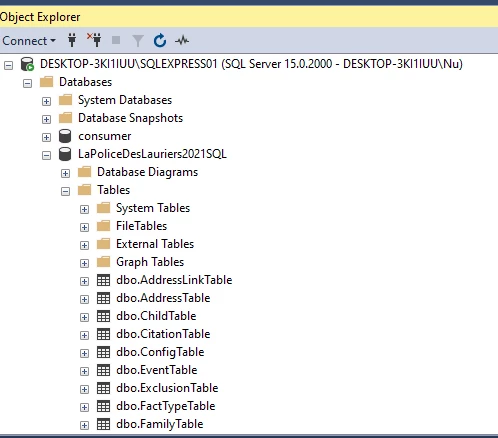

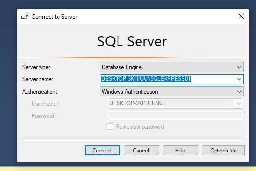

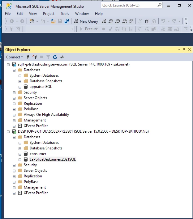

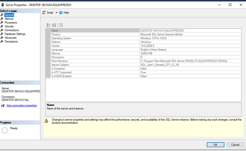

    I want to thank Dave & BKBK for your advice. I still have not been able to establish the SQL DB as a CFDatasource.
    Here are a few more images- CFAdmin now throwing a different error. Thanks again!
