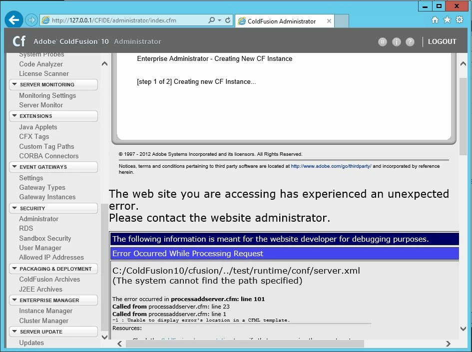

Can't create coldfusion instance
I installed CF 10 server installation, tried to create a new instance in the instance manager, and I'm getting a ColdFusion error for page not found (attached). I've tried several times. This is on a Windows 2012 server using the Administrator account

    First, technically that’s not really saying “page not found” but rather “file not found”. Anyway you see it’s trying to access the server.xml file within a “test” instance. I assume that’s the instance you were trying to create.
    Can you confirm if it even created that test folder (under the cf10 directory, where instances are created)? If the folder’s there, is the file (server.xml) there, in its runtime/conf folder? If it’s there, and you open it, does it have content? It should be about 20 lines of XML (without comments, which make the same file in the cfusion directory a bit larger).

    The directory was never created. I thought it might be a permissions issue, but I set the coldfusion folder permissions and tried again with no luck. You may be onto something with the installer. I also have the issue where the CF admin password does not work after install, so I have to modify the security xml file. I will look into getting another installer. We bought a whole bunch of licenses over a year ago and are just now getting to the nitty gritty of setting up the installation procedure. Upgrading at this point is not an option, since we spent a ton of money on the CF10 licenses already.
