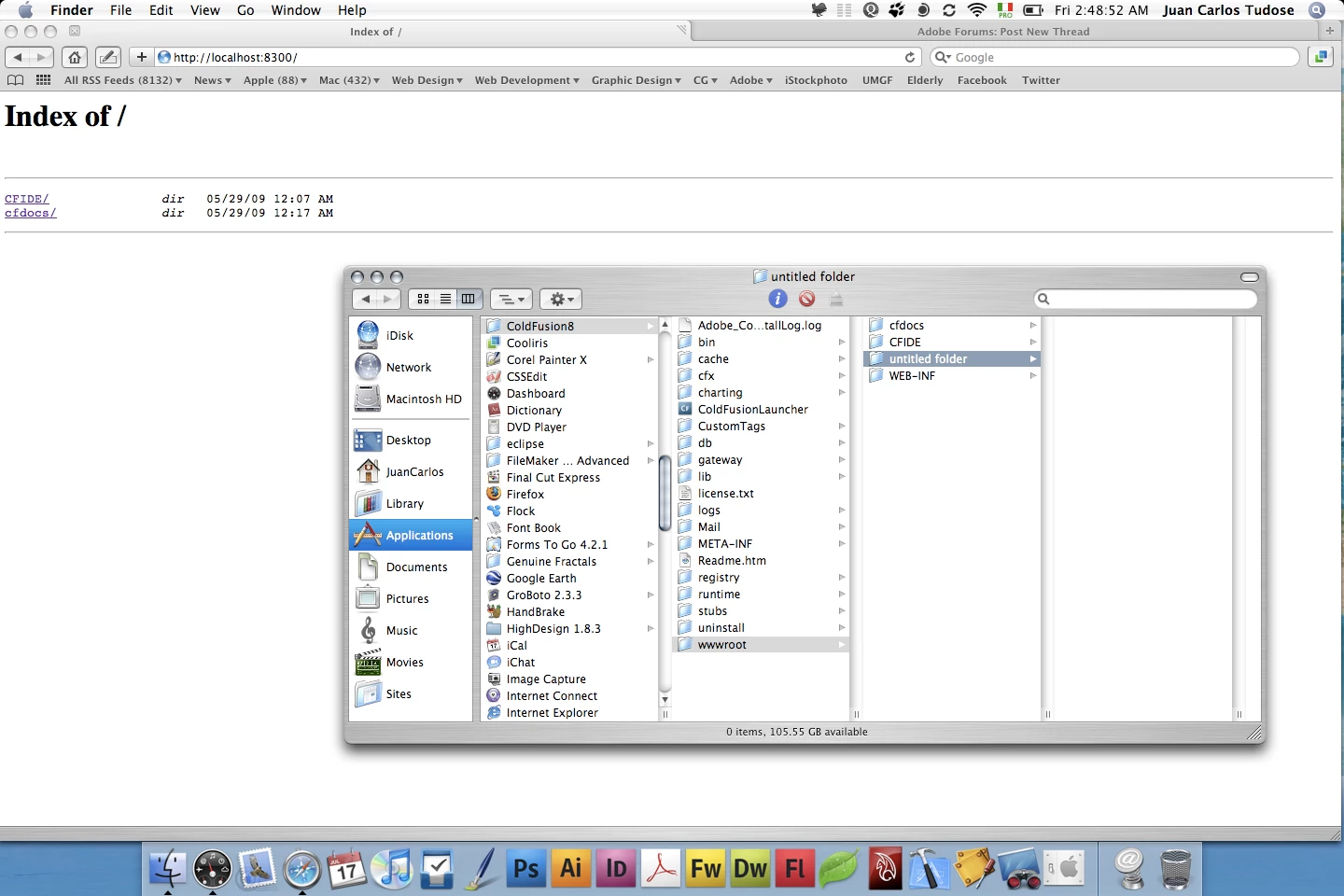

I just installed CF8 Enterprise Edition as multiserver and I have this problem: After I created a new folder in Applications>ColdFusion8>wwwroot I try to see it in Safari @ http://localhost:8300/ but I just can't see my new folder.
Any one has a clue about this?
Your replies are much appreciated.

During the install did you configure CF8 (since you're on a Mac, make sure you used CF 8.0.1) for Apache via web server connection/configuration? If not, you may want to reinstall and do this. This will configure CF8 to run on port 80 (integrated with Apache) so that you access your sites at http://localhost/. I've had better luck with CF on my Mac when I installed CF on top of JRun4 (option when installing).
Mark Drew has a good post with screen shots of this install type:
http://www.markdrew.co.uk/blog/post.cfm/running-coldfusion-8-on-leopard
Back to your OP, it looks from the screen shot like you don't have the folder in your path (but it certainly should show up in the list). Under the current setup, can you add an index.cfm (or any CFM file) file to /Applications/ColdFusion/wwwroot? Then load that in your browser to see if CFM files are being processed. It'll at least tell us whether or not CF is 'working'.

I forgot to mention that I have a folder in the Applications named JRun4, and in that folder I also have servers>cfusion>cfusion-ear>cfusion-war.
It is in that last folder, that I just discovered, that I can see the folders @ http://localhost:8300/ i.e. CFIDE, cfdocs, WEB-INF.

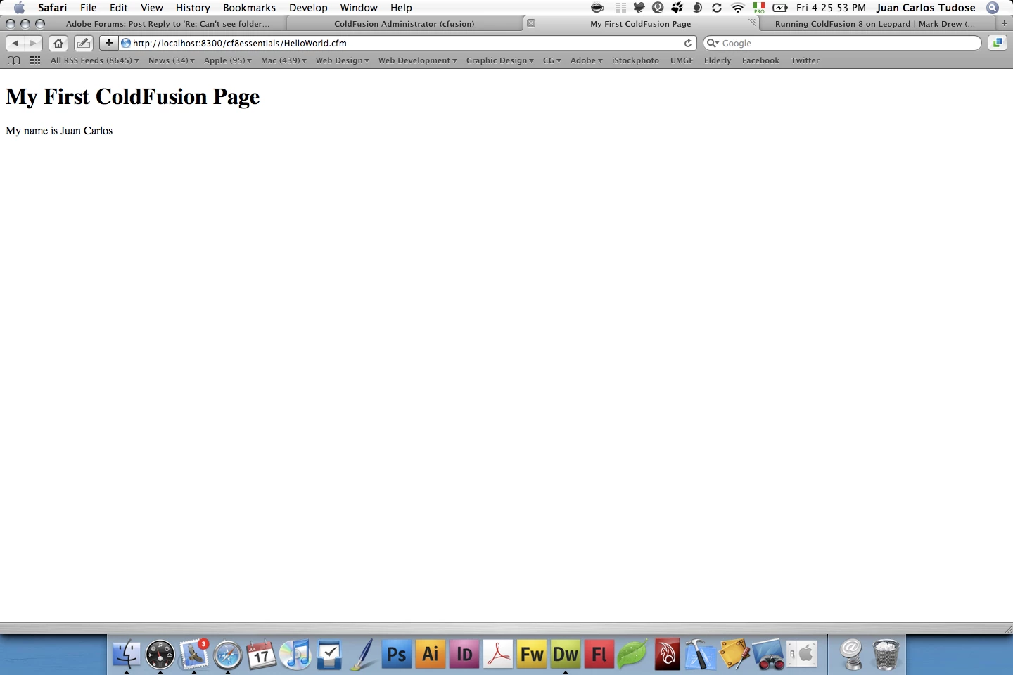

I've created the index.cfm page as you suggested, with this code:
<!DOCTYPE html PUBLIC "-//W3C//DTD XHTML 1.0 Transitional//EN"
"http://www.w3.org/TR/xhtml1/DTD/xhtml1-transitional.dtd"> <html xmlns="http://www.w3.org/1999/xhtml">
<head> <meta http-equiv="Content-Type" content="text/html; charset=UTF-8" /> <title>My First ColdFusion Page</title> </head> <body> <h1>My First ColdFusion Page </h1> <cfset firstname="Juan Carlos"> <cfoutput>My name is #firstname#</cfoutput> </body> </html>
Seems like the CF server works; This is the output:
So far so good, I'm tempted to say...
Do you think the results are correct?
Thanks again.
JC
ilssac
May 29, 2009
Yes, the JRun4/servers/{servername}/cfusion-ear/cfusion-war/ is the first place ColdFusion configured in Multi-home configuration will look for coldFusion files.
But to server up non-cfml content you must run the web-server connector tool to connect each server instance to one or more websites configured via your web server, Apache I presume on an os-x system.  The web root of these web sites would then be the second place ColdFusion will search for cfml files.
