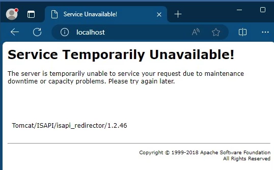

I am trying to install ColdFusion 2023 on a new Windows virtual machine.
I set it up as Development Type - Development with CF Server Profile - Development Profile.

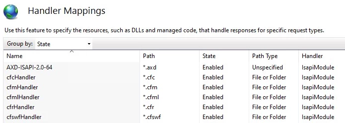

After installation I ran the Web Server Config tool and added the IIS website/all
Here is what IIS has after installation & web config
After this I tried to access the localhost and receive this error message
The ColdFusion administration doesn't load either

    Jen, as you discovered, the errors you should would have suggested cf is not running. Glad you sorted that out.

    3) Finally, as for your showing a CFIDE virtual directory in  iis, that would not have been done by the cf wsconfig tool...at least it's not been done (a CFIDE vd added) since cf2016, which is when they switched to the cf_scripts (for serving js and other files needed for some lesser-used cf tags). As for admin access, that version started enabling the built-in web server defaulting to 8500.
    If you look at that CFIDE vd in iis, you will likely find it points at some folder other than your current cf's cfusion/wwwroot/CFIDE folder, and as such it should be removed.
    And FWIW, a cf (and wsconfig) update last year now even explicitly prevents the connector from passing into cf any CFIDE request. (I suspect BKBK wasn't thinking of that and the previous point when he proposed you try that CFIDE url.)

    CF_JenAuthor
    April 4, 2024
    Hello BKBK,
    Turns out the ColdFusion Application Service was not started.  Once I started it I was able to access the CF Admin.
    Now i'm running into issues where I am unable to access my site via another computer.  I believe this is an IIS issue and not a ColdFusion issue.
    Thank you for your help.
