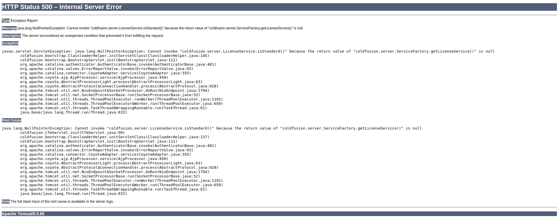

Cannot invoke "coldfusion.server.LicenseService.isStandard()" Error
I am getting the error posted in the title, the full error is the following...
Cannot invoke "coldfusion.server.LicenseService.isStandard()" because the return value of "coldfusion.server.ServiceFactory.getLicenseService()" is null
I have applied the hotfix-007 patch already as per instructions from https://www.carehart.org/blog/2023/10/10/solving_problems_applying_latest_cf_updates
Any help is appreciated, thank you.

    It seems you have installed the update without applying the fix -Djdk.util.zip.disableZip64ExtraFieldValidation. What happens when you try the following (assuming ColdFusion plays along) :
    1.  Open /cfusion/bin/jvm.config in an editor;
    2.  Add -Djdk.util.zip.disableZip64ExtraFieldValidation=true to the java.args property;
    3.  Restart ColdFusion.
    4.  Check whether it is then possible to launch the ColdFusion Administrator.
    5.  If so, launch it and go to the Package Manager page. Verify whether Update 7 is installed. If it is not, then try installing it via the Administrator.
    6.  If you're unable to launch the Administrator, let us know. You will then need a different set of suggestions.
