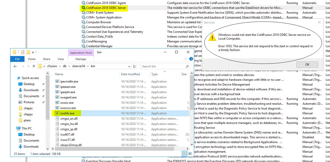

Hello - I recently installed ColdFusion Standard 2018.  I tried to add an MS Access data source, but I noticed that the ColdFusion 2018 ODBC Server was not started.  When I try to start it, I see the error in the attached.  Has anyone encountered this?  Any suggestions?  I am not able to start the service.  Thank you.

    Coolidge, to be clear the service works so whatever is amiss is a local issue. Could be any of several. Tough to list all here, so let's go a couple at a time. And even if a question seems obvious or dumb, we can't ignore any possibilities in a case like this.
    Are you sure the process you point to was not running already? It could be, and yet not show as the SERVICE running it.
    If you go to the command line, as admin, and run the same command shown in the service (including any args there), do you see any error at the command line?
    And I'm not at a computer at the moment, but there's a port for the odbc service that may be amiss somehow on your setup.
    Reply to the above as a  start, and next time I respond I'll be on a pc to test things and suggest more, if needed.

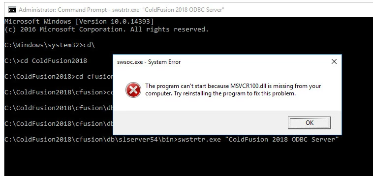

    Charlie - Thanks so much, really appreciate the help.  Here's what I see when I run the command from the command line.

    OK, that rings a bell, then. I recall a discussion here in the forums in the past couple of years, where people reported that upon applying a certain CF update, they found this happened--because the update had REMOVED that file when it should not have (or it should have replaced it with an updated version).
