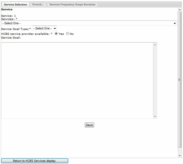

    The difference between the build for devlopment/test and production is due to licensing issue.
    Below is the screen shot between test and production.
    Test
    Production
