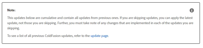

    Update#3 just released as I was going through all this.  It doesn't mention any installation issues related to the auto-lockdown configuration in the release notes.  Has this been fixed?
    Miguel-F
    Mar 29, 2019 11:51 AM UTC
    Don't rely on the fact that the latest update does not mention any installation issues like the previous update did. I have noticed that Adobe is no longer copying forward any specific instructions from previous updates. Instead they are posting a note on the new update to refer back to the previous update(s) to see if there were any specific instructions.  So they are leaving it up to us to dig through all the updates and see what we need to do.  i don't like it.
    here is the note I am referring to:
