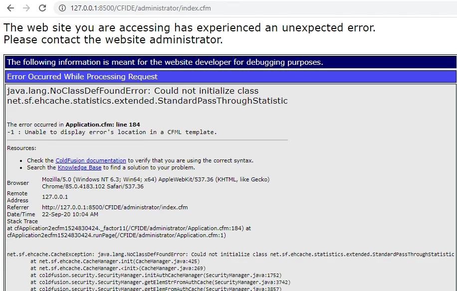

Today, for hte first time, the CFIDE administration page showed a CF error dump.

> ... the CFIDE administration page showed a CF error dump.
Could you please share the error dump.

BKBK, did you see the other comments from the 21st? I'd think the first question for Michael is rather whether the problem was resolved by the removal of the maxmetaspace. Given the discussion, I think that probably resolved it.
But yes, if somehow it did not, it could help to see the error. It could also help to view whatever error lines might also have been written to any of the CF logs at the same time that error occurred, if the cause is perhaps not obvious from the error shown IN the admin.

BKBK
Sep 28, 2020 5:08 PM UTC
Yes, I saw the other comments. My own comment has a different perspective. Whether or not the metaspace solution works, and I hope it does, it would be helpful to the community to document the error for posterity.
