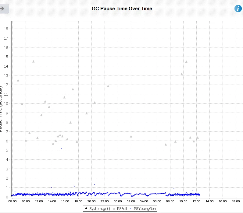

GC logs indicate that it is not caused by STW gc.

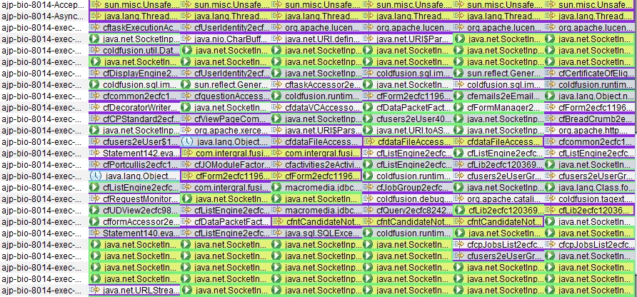

Here you can see lots of workers Waiting for Condition (the purple bits). These stack traces (columns) were taken 2 seconds apart. The code that is in each frame changes, but as you can see, they almost always are Waiting for Condition.
The top of the stack traces are all similar - our CF code followed by some Java code.  Nothing to indicate what the condition (object?) is that we are waiting on.

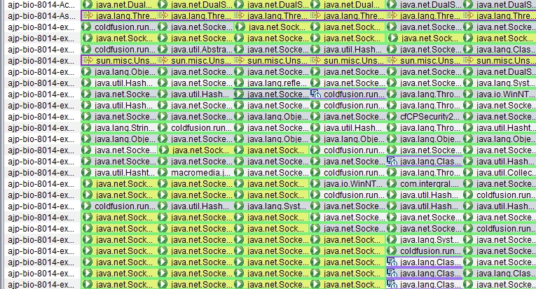

Here is a series of thread dumps when everything is good.
I'm not sure where to look from here, it appears that something in the JVM is causing Locking/Blocking/Waiting.
