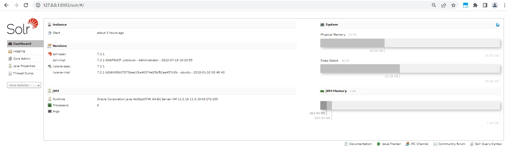

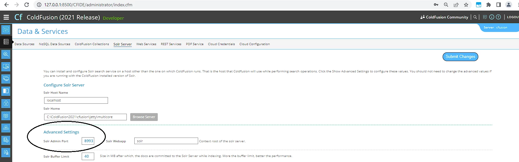

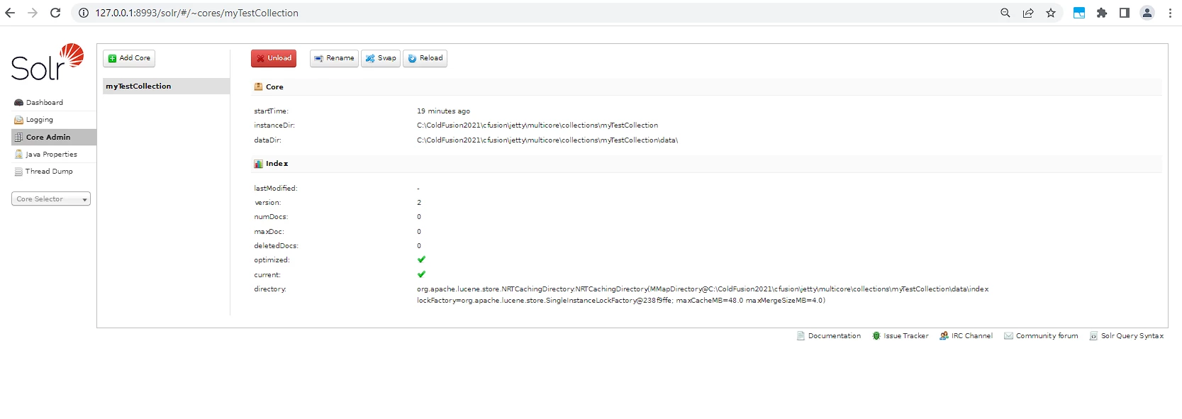

There is a workaround that does not involve code. It goes as follows:
  1.  Open the ColdFusion Administrator. Navigate to Data & Services > Solr Server. Read off the Solr port number. Mine is 8993.
  2.  Launch the following URL in the browser: http://127.0.0.1:{portNumber}/solr/#/
         In my case, this is: http://127.0.0.1:8993/solr/#/
    3. Click on the Core Admin menu. Select the collection and press the Reload button.
