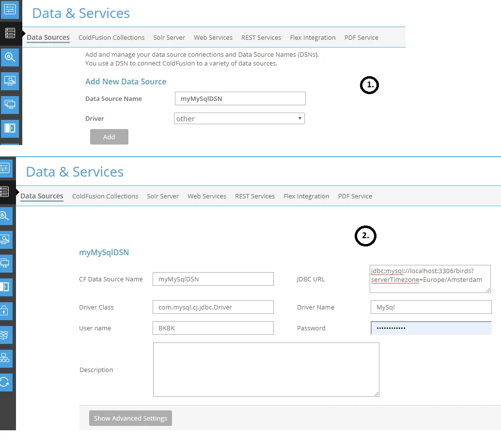

    Hi @weezerboy,
    As luck would have it, I also had some difficulty with MySQL only days ago. I wanted to update the MySQL datasource on my ColdFusion 2018 from version 5.x to the current 8.0.19. I should like to share with you the steps that I followed to get it to work.
    1) I opened the datasource page of the ColdFusion Administrator and copied the properties (DSN name, database, server, port) of all the MySQL datasources; (Ignore this step if you don't yet have any MySQL datasource)
    2) I then stopped ColdFusion, opened the directory C:\ColdFusion2018\cfusion\lib. It contains the MySQL ddriver I wish to replace, namely mysql-connector-java-5.1.48.  I moved the file to a back-up directory outside ColdFusion. (If you have no such driver file, then you should ignore this step)
    3) I went to MySQL Community Downloads , chose the "Platform Independent" option for Connector/J 8.0.19 and downloaded the Zip file mysql-connector-java-8.0.19.zip (size: 4.4 MB);
    4) After unzipping, I copied the file mysql-connector-java-8.0.19.jar to C:\ColdFusion2018\cfusion\lib.
    5) I restarted ColdFusion 2018, and went to the datasource page in the ColdFusion Administrator.
    6) For each MySQL datasource, I recreated a new datasource using driver "other" and driver class "com.mysql.cj.jdbc.Driver", as in the following images
    As you can see, MySQL is installed on localhost, port 3306. This particular datasource is for the my birds database.
    7) I pressed the "Verify All Connections" button (in CF Admin) to verify the datasources, and then ran some queries in CF to confirm.
