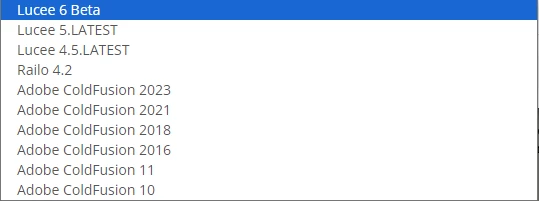

    I ran the code, as below, on https://trycf.com
    <cfset aff_payment=7.875>
    <cfoutput>
    <b>Test 1</b>
    <br>
    Before rounding: #aff_payment#
    <br>
    After NumberFormat rounding: <b>#NumberFormat(aff_payment,"9999999.99")#</b>
    <br><br>
    <b>Test 2</b>
    <br>
    <br>
    After NumberFormat rounding with ToString: <b>#NumberFormat(ToString(aff_payment),"9999999.99")#</b>
    </cfoutput>
    I used each of the following 10 CFML engines in turn:
    However, none of them reproduces the 7.87 result. In each case, the result is 7.88 for Test 1 and for Test 2.
