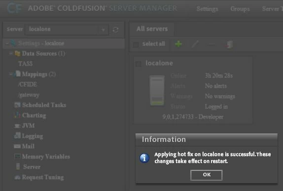

I have been trialling ColdFusion Server Manager.
With CF SM you can apply hotfix remotely.
Cumulative hotfix 1 (CHF1) for CF 9.0.1 has some manual steps:
http://kb2.adobe.com/cps/862/cpsid_86263.html
I suspect you still need to perform the manual steps connected to the server? Does that reduce the usefulness of SM for applying updates hotfix?

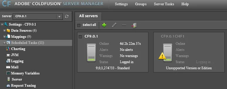

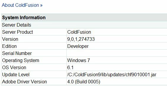

Since applying CHF1 to CF9.0.1 SM can no longer connect to those updated CF servers. Eg:
Has anyone else tried CF SM with CF 9.0.1 + CHF1?
Regards, Carl.
    January 20, 2011
    Well I restarted the whole server that CF9.0.1 + CHF1 is running on and now CF SM can access it again.
    Would seem to me CF SM does not provide any advantages when it comes to applying hot fixes. Curious as to others thoughts on the CF9 SM feature?
    Thanks, Carl
