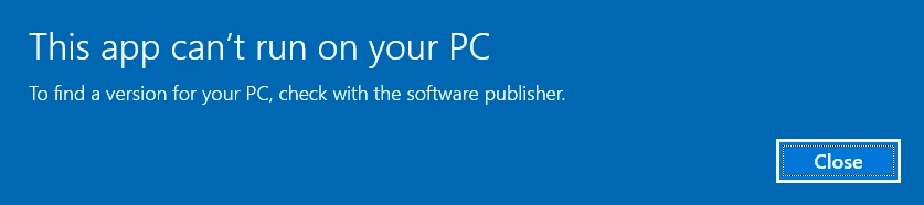

I'm getting "The app can't run on your PC" anytime I try install the CF 2018 update 13 on my Win2019 Server.  How does one go about this issue. I'm running CMD as an admin, I've enabled all admin security on the group policy but still the same issue.
See attached document

    I'm running the below command as an administrator and getting the error I attached on my first question
    C:\ColdFusion2018\Hotfixes>C:\ColdFusion2018\jre\bin\java.exe -jar hotfix.jar

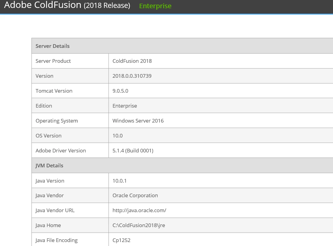

    The current CF 2018 Update level might be too old for Update 13. Let's find out.
    Open the ColdFusion Administrator. Click on the (i) in the top right-hand corner. You should then see the System Information page.
    What are the entries for:
    (CF Product) Version
    Java version
    May 3, 2022 1:47 PM UTC
    See above.

    BTW, your screenshot here shows us you have no cf updates, no Java updates, and the Java 10 from the original installer for cf2018. Just observing, not saying it has any bearing on your problem necessarily.
