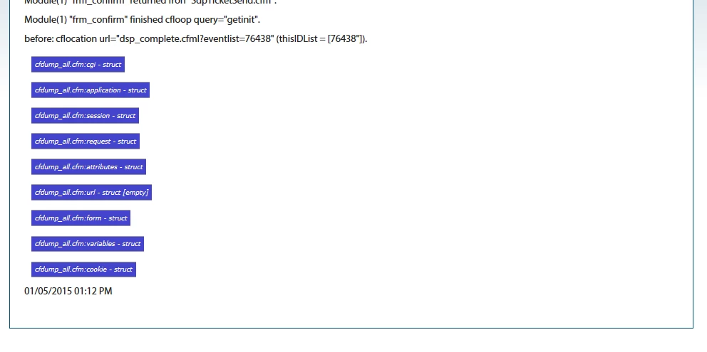

    Program Code:
    315
    316    <cfset thisIDList = left(trim(thisIDList), len(thisIDList) - 1)>
    317 <p><cfoutput>before: cflocation url="dsp_complete.cfml?eventlist=#thisIDList#" (thisIDList = [#thisIDList#"]).</cfoutput></p>
    318 <cfinclude template="/includes/cfdump_all.cfm">
    310 <cflocation url="dsp_complete.cfml?eventlist=#thisIDList#" addtoken="No">
    320 <output>after: cflocation url="dsp_complete.cfml?eventlist=#thisIDList#" (thisIDList = [#thisIDList#"]).</cfoutput></p>
    321 ...
    Web Output:
    Module(1) "frm_confirm" returned from "SdpTicketSend.cfm".
    Module(1) "frm_confirm" finished cfloop query="getinit".
    before: cflocation url="dsp_complete.cfml?eventlist=76438" (thisIDList = [76438"]).
    cfdump_all.cfm:cgi - struct
    etc.     :
    Web Display:
    Note
    Note: page's footer links (below "box") are not output.
    First displayed line in target <cflocation> :
    147 <p>(3) In "dsp_complete.cfml" Start...</p>
