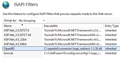

    WiWildcatAuthor
    Jan 10, 2014 5:12 PM UTC
    This is likely the culprit. Anyone know how to get rid of it? It won't simply go away when I hit the delete button.
