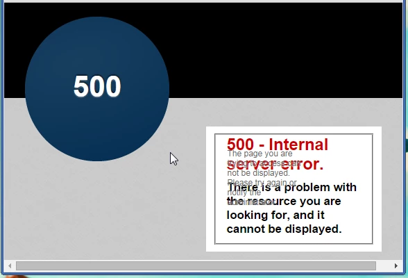

In WIndows Services, my cfintra instance is running. In CF Instance Manager, my cfintra instance is stopped, and I can't started via this page. In CF instance logs I get this:
And visiting my website simply returns a 500 error. So I started the CF instance via CMD with: coldfusion.exe -start -console and now my website is running. However, the status of the instance in Windows Services is 'stopped' and if I close the CMD window it shuts down the CF instance. I have 4 CF instance that I'm managing via the instance manager and CFINTRA is the only one I can't start and stop successfully from the manager. So, how do I debug this issue?

Ha, I actually applied the update to all instances, but the hf-11-0001.properties and hotfix_001.jar files are not located in the update folders of my instance, only in the main cfusion instance folder. Plus the issue went unresolved. After I restarted the operating system this is what I got:
As you can see in the instance manager, CFUSIONINTRA has "started", but in windows services it says its "running". Website:
