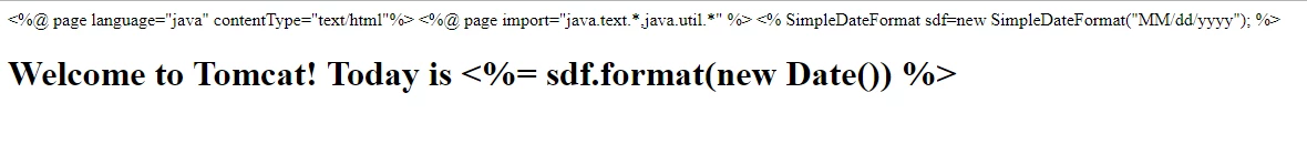

I'm upgrading our server from CF9 to CF2016 now. CF2016 can successfully talking to Apache and our cfm web pages seems working perfectly with cf2016. However, all the .jsp files stopped working. When trying to access a simple test.jsp file throught https://our_web_url/test.jsp, the raw code displayed like this:
Any hint on how to debug next would be really appreciate!

    I put the test.jsp file in the wwwroot and try to access it via out virtual host, still only displaying raw code. Is there any handler mappings like Dave mentioned I need to do?
