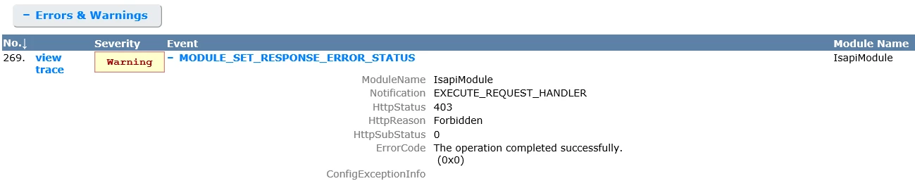

I just enabled Failed Request Tracing. I get no Error, however a warning:
I will now try what Priyank suggested.
